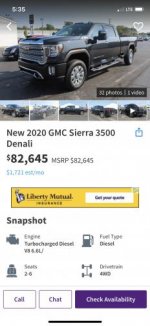

I've been having to put in entirely too many hours at work lately so I'm moving a little slower than I would like. I did manage to finish up the head install work, dropped the lifters in after soaking them in oil for a few days and installed the intake manifold with Cat. She seemed to enjoy using the torque wrench, but 18 ft-lbs was all she could muster. Sadly no photos as the girls were up early and ready for breakfast.
In other news a buddy rented a trencher and mini-skid steer to do some work and was done with it, I offered to fill them with fuel if he let me borrow it on Sunday. I also picked up 2 20' (6.5m) pieces of 7" OD pipe, I needed to do something about this:
That was from when Andy helped me with my drainage and water intrusion issues. It has been working flawlessly but it was time to put in the drainage pipe so I didn't have a dip on entry into the shop:
That was after many trips pulling sand and dirt out near the entrance to the pasture, I then tried to clean out the ditch, didn't work so well and wife had to pull me out twice:
That was really all I was able to accomplish after spending all of Saturday at work. I did look at a new trucks online and was shocked at how expensive they had become:
For slightly less money I could get this and have way more fun!
Sadly I don't have the money for either so I'll just keep dreaming.
JB

realvc
Jan 7, 2011
394
Lake Norrell, AR
I have a 1999 Chevy Z-71 with a little over 200,000 miles on it. When I check out the newer than mine used trucks the prices are insane to me. The trucks that are newer and at a reasonable price have way more miles than my truck.
You are way a head of the game since you can do your own mechanic work.
I plan on keeping mine going as long as I can since I don't see them getting more affordable any time soon.
Vince

Vince,
I completely agree, just too rich for my blood. I know inflation is a big part of that cost increase along with more technology, convenience features, and safety equipment. But for many of us in the US that is getting close to the price of a house. It actually is almost 3 times the cost I paid for a pretty nice little home a few years back. WOW.
JB

I think there is another aspect to the pickup prices. They build in a really big profit margin and then offer you 20% off so you feel like you are getting a deal with $16,000 off. Or they sell it to you for list price and give you a 0% loan for 60 months (or longer) so the monthly payments are close to a second mortgage. I've always bought used and paid cash because I hate owing money. I'd rather drive a paid-for POS than be a co-owner of a beautiful and depreciating brand new POS.
J
jbmatth
Jun 3, 2013
5,694
Northern Ok.
You are very right there Bob, I regularly hear about trucks being discounted by $16,000 or more. Why would someone buy at MSRP then? Even at 84 months with 0% (Offers I've seen before) that is nearly $1,000 a month. On the other hand look at a similar 3 year old GMC 2500 Denali with under 70k miles you are looking at nearly $40k for gas and $45k for diesel.
I'm having a *shakes fist in the air* "Back in my day..." moment, I just can't justify it but sadly with those being so expensive they have driven up the cost of even the POS so high it is hard to justify them. That is when I get back around to just keeping what I have and fixing it again, or building a McLaren engine for the cobra. :lol_hitti
JB
JB
I want to see you pull a trailer with a Mclaren!
Oddly enough I was playing on the Chevy website. The cheapest truck I could configure was still $30k. That was a 2wd regular cab long bed WT trim.
I have never bought a new vehicle. I want to own what I have, not just have the bank let me use it.
