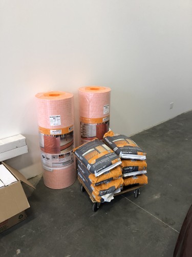

Through my research of many companies (some are well known tile products companies, and some are just generic knock-offs) offering uncoupling membranes, in the end, I got to stick with a trusted brand name; Schluter Ditra system
Notice the thinset is "Mapei"
Here's a funny story with switching to Schluter "SET" thinset. So I have no clue how the tile industry works (my tiles came straight from tile distributor warehouse). So during my multi visits to tile places, I've been just stopping everywhere asking for 1,200+/- worth of tiles.

The thinset switch up story is, originally, we were going to use Mapei to lay Schluter Ditra. But the retail store found out for only a few bucks more (per bag), he could get Schluter "SET" thinset. By now, everyone is rooting for me on this project; Vaults developer, the tile distributor, and retail tile store... so to a point where the retail tile store owner delivered these 8 bags of Schluter thinset, just to get a chance to visit the Vaults and switched up the original Mapei bags.
Even though I'm probably spending more than I should... but I'll try saving $$ whatever ways. So, to lay the Schluter Ditra, you need a floor roller. I just don't feel the Schluter Ditra roller at $250 Cdn is worth is (especially for 1 project use, and at this point of this update, yeah, I don't think I'll be tiling another project anytime soon)
So I just made my own Ditra roller, with a $15 Amazon rolling pin, with scrape boards.
Since each box of tiles are 50 lbs (Ditra says can't exceed 75 lbs)
But that original design was too top heavy, and the box of 24" square tile was way too cumbersome. So had to re-design the roller, after I got annoyed doing 200 sqft ish of Ditra.

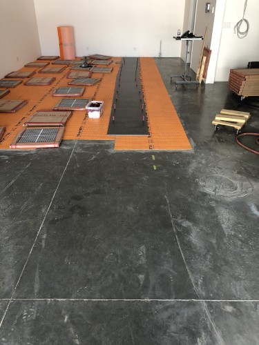

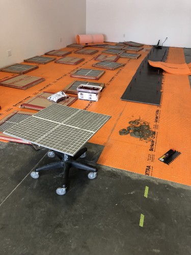

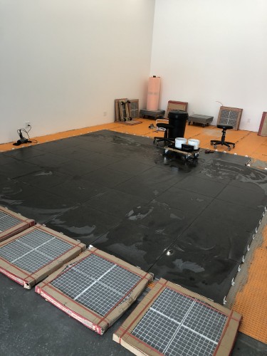

Laying Ditra uncoupling membrane
Dry layout of tiles
I won't even try to over write or explain this. Basically, I understand you're tiling from centre. So I like the slab cut lines the Vaults developer left, so I'm just using that as a straight line, and then measuring off the relief cut lines towards my tiling centre line.
And with this tiling laser, I didn't even snap chalk line.
First tile, centre of unit.
Using this office stool chair as my tile back butter spinner, greatest $99 cdn I've spent, had this chair over 10 years.
Because I got stuff, I have no choice but to grout in sections. Another tile retail store (not the one supplying the Schluter stuff), says this particular charcoal grout will blend in nicely between different sessions. (as of this write up, I've only done 1 grouting, we shall see how accurate his suggestion is the grout would match seamlessly. But regardless, I still need to grout certain areas, so I can put stuff on it)
As I move along, picked up a few actions to speed myself up, just a trial and error process. Every bucket (50 lbs thinset), only gets me about 12 pieces of these 24"x24" tiles, which is consistent to Schluter expectation of 50-75 sqft coverage for the size of towel (1/2") used.
It might not look much, and I still have a longgggggggg ways to go (don't even think I got 15% done, I'm factoring in edge cutting labour, and baseboards will be tiled too)… This is going to be one hectic summer

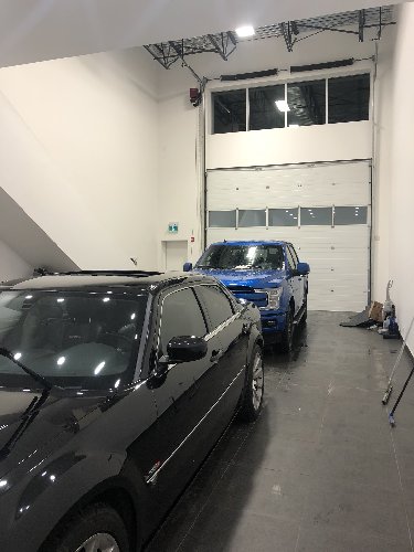

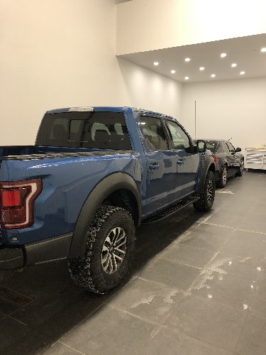

Here are some money shot on my Vaults porcelain tile work, I've been busting my *** all summer. As of now, I'm also committed to work at my career job, so these two warehouses (The Vaults storage), and the "new to me" 1968 old cinder block downtown 2,000 sqft "auto appearance" warehouse are going to have to be side projects.

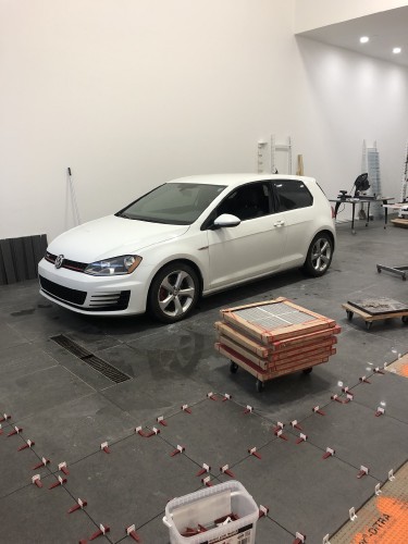

Here are photos of my Vaults unit finishing up tiling, LFT Large Format Tile 24"x24"
I'm really happy I took WEEKS measuring (I'm not even kidding, I've been measuring even before I got possession of my unit back in 2017, when I DREAMED about tiling). I kept telling the Vaults developer and the supervisors to thank the contractors that installed the trench drain (1 section of 4' preformed), and the concrete relief cut guys. Because I based my 1st first tile off of those lines.
And I'm so lucky my measurements paid off, where I cheated on wider grout line (I used 1/8", but as you see the trench drain it's a little "off" as the tiles are technically 23.75" and the trench drain section should be 48")… But what I wanted is exactly this look... I did not want the side tiles to have any "U" cuts
And as for the raised tile, causing the trench grate to be lower... I bought flat bars (no photos), i.e. lift up the grates, epoxy glue 4' flat bar strips where grates would sit on.
So the next session I'm at the Vaults, as you see, the tiling haze (be it from grout, or thinset and my foot traffic during install was just smearing all over, I sworn I was careful) Based on good old Goolge and tiling forums, sulfamic acid and some elbow grease should take care of it. (so bought some acid based, and a non-acid base grout/thinset cleaner from Home Depot) Fingers crossed when I have time on the next session.

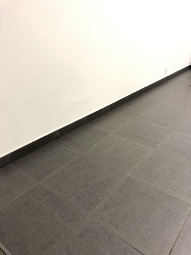

Drives: I purposely drove up to get these photos to reply. Hopefully you won't regret asking, with my long explanation. Sometimes as a blue collar guy, it just takes me more words to articulate my description take paragraphs or pages as to someone else's few sentence.
Ok, but I'll try. GJ is such a professional crowd with the same mindset (cool garages, warehouses, workshops), so thanks for the patience in my ADHA assembling a story.
Ok, in answer to your Vaults garage condo, porcelain tiling (issues, steps, stories during tiling as a DIY first timer)
1. The tile (10mm thickness) to the man-door "step plate" I was having more mental and OCD planning on how to execute this. How will the tiling end at this area? In another unit that had professional paid tile guys, the pros used another transition trim facing the door's step plate to concrete floor level (so two **** endings "V" shaped facing each other) if that makes sense. However, I didn't like how that look isn't organic or smooth flowing enough. (transition finish on lower floor, butting up against another transition having that V groove, and only to run your feet on tiles)
So for me, this took me 4-5 hours (wasn't a half day continuous, I just took different sessions). The 10mm tiles, roughly levels with the highest point of the step plate. So I just grinded off the transition part; however, because the builder used insane glue/bonding thingy keeping the step plate, I couldn't remove it completely to jigsaw, I had to hand grinder it on the floor, and a lot of time spent using Dremel to make sure the cut was smooth.
But the result is, when you walk into the unit, you can glide you feet/shoes along the aluminum step plate, and there's no "tripping", it's just one smooth shuffling into the tiled shop.
2. Hand grinder with diamond blade cut two pieces of "U" shaped full 24"x24" tile, being the scraps being cut out so large, that you had to take your time. (it's not the point of wasting a $16 Cdn tile, even if you break it, at that point, just start with another fresh piece). It's the tracing (I didn't use any of those plastic tracer tools, just cardboard from the tile boxes, and tape, paper, scissors, then marked it on the actual tile)
3. Two pieces of how to transition the garage door rails. Measuring, tracing with cardboard, and hand grinded that curve.
4. OMG, this might just be one photo... but, it's giving me nightmares just typing about this. It's the border perimeter (so maybe 120' feet length). So my OCD wanted grout on top of the border tile, and the trim. HOWEVER, when it came time for grouting, the float was getting all over the wall. (I hope anyone who's tiled can tell me what I did wrong)… so I basically "hand fed" 120' length of 3mm thin grout line into the perimeter border top trim
5. This, should be self explanatory :( everything associated with this photo. I should had "boxed it". Nope, I went as angled as I could to follow the natural of the build (but why? don't ask) So from tiling, to grouting, trim piece, etc...
6. Making sure the 4 pieces of transition was "square" as I set them. And that the grates can be pulled up and cleaned, and cutting tiles leading to trim. (there were minor grinding as in shaving some tile edge involved)

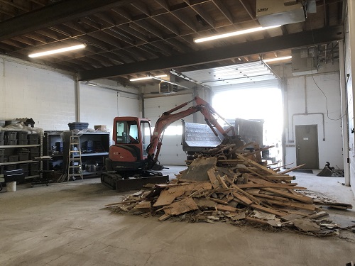

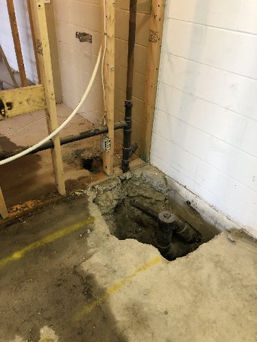

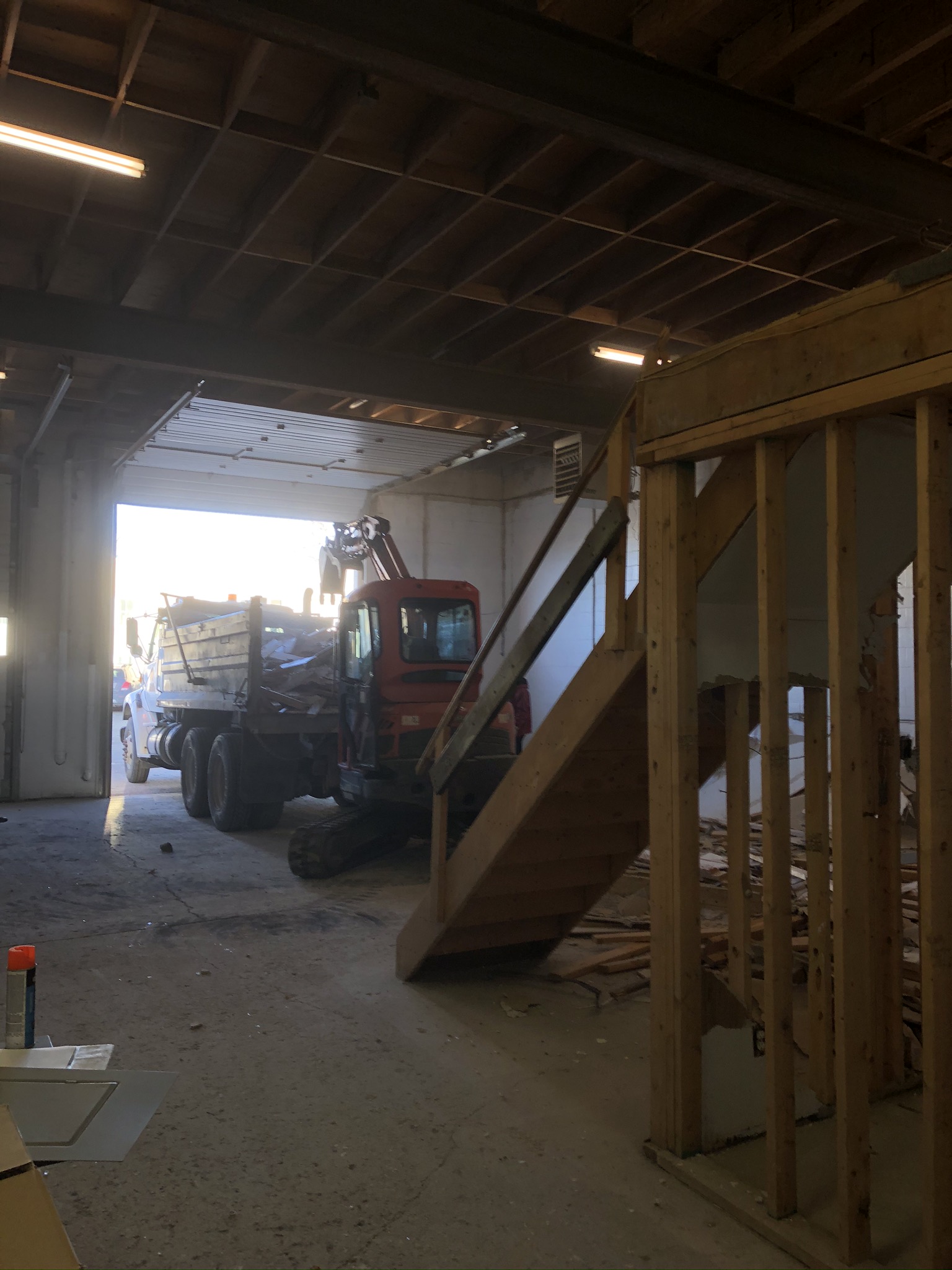

Ok so this post is on the 1968 cinder block 2,000 sqft warehouse
I've been working (well, just paying engineers) on city permits. Just a lot required from the city to update it to planned renovations. Mostly, I want the mezzanine (legal) as large as I can build it. (there's size maximum ratio to main level size, enclosure area measurements etc)… When things get settled, I can post more... I'm still dealing with some buzzkill changes back and forth. But basically, lots of drawings are "stamped" and city approved. (but some, you just want to make sure the changes within the drawings, even if minor, are ok, and then re-submit with the engineer to the city, etc)
In the mean time, there're cosmetic time killer stuff I'm been doing. (so along with finishing Vaults garage condo tiling, regular work, and these little weekend stuff I would come to the 1968 warehouse for)
- Painting the walls bright white with rollers. (yes, when the time comes, I'm going to spend money on a Graco sprayer; but I'm on a cash flow crunch, so I'm just brightening up the place with rollers that I already have)
- These Lowes/Home Depot industrial shelves on heavy duty caster wheels (they've traveled through 4 properties now, I think this is the final resting place, if I end up selling this 1968 warehouse, I'm just going to sell, or leave them to the property buyer, lol)
So 2 out of 4, I wrapped them with roofing tin, then basically put painted plywood as a work bench surface. So two of these grey shelves will just act as rolling work bench and tool chest.
There's one more activity update I'll do in the morning (it's 2:45 am here), but at least I've got PhantomEB back tuning in again.

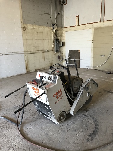

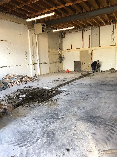

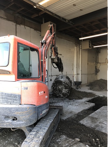

With these photos, this will bring us to the current state the 1968 cinder block 2,000 sqft is at... So:
- city permits approved, going to wait till 2020 to get any consulting going. Trying to sweet talk developer of the Vaults garage condo to take time and give me a hand. Or I'll slowly form my own team of contractors and follow city code, and what's approved for renos.
- the cosmetic stuff I can do, remove paint booth

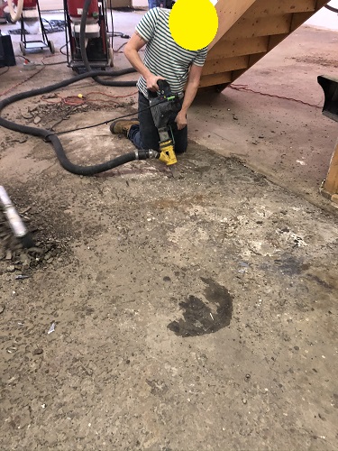

- in this post, because it's been a furniture builder's shop beforehand, the old 1968 concrete flooring has quite the build up for the past 30-40 years of use.
Trying to save $, and doing as much work myself. I "considered" and looked thinking of renting my own flooring grinding equipment. Showed the rental store my project photos, and took a look at the rental store equipment. Of course, my best calculated guess is, I better hire pros for this, and glad I did.
These guys are just awesome, their company specializes in these flooring clean ups for commercial buildings. (10,000 sqft downtown office moving out, and the landlord requires the tenant business to strip everything down to bare bones for the next tenant business)
First, they had to jack hammer the heavier buildup.
Again, so glad to be hiring pros (obviously), and the right pros. Look at all their equipment, along with insane vacuums. There was no way my rental unit could had done this job. imo
The result is a freshly cleaned, level surface. This floor grinding company also has a division that does epoxy, however, giving the deep 30-40 years worth of deep pitting, even the owner (after seeing photos of Vaults tiling), agrees, just lay some tiles over at this point. (to level that properly for epoxy floors would take multi steps than a fresh pour)

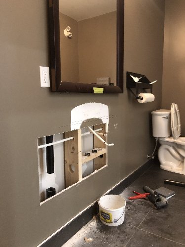

Last Vaults reno I did was... changed out the main level sink.
Had to hire (The Vaults) plumber, because I want it done properly to code. (the way the height for P-trap goes, number of angles on joints)
Then one friend offered some money, to store his black SRT 300, though it's only a fraction of expenses, but sure why not.
Then last week, it was cold and a buddy that works at a dealership had a good employee deal on a F-150 Raptor, so he got rid of his F-150 Lariat. So requested my help with switching his tonneau cover
But wow, in person, the Raptors really are a cool and nicely designed truck

Started with the plumber jackhammer the sewer hook up for my unit (adding mezz bathroom with shower), and kitchen/sink area, shop washer/dryer.
And possibly look into "expanding" EXISTING lower bathroom.
As the plumber was jackhammering to get to the sewer tie-in, I was just ripping drywall
haha, so I'm sure you guys all knows how this goes... you start ripping, thinking ok I'll stop "HERE", then it's like "ahhh why not, might as well rip that too"... but to a point the mindset goes; ok, I guess this is a To-The-Stud reno at this point.
PROBLEM was, till plumber and I got to ripping the ceiling down (i.e planning his vents, upper toilet, etc.)
The wirings were so hacked up, (at that point staring at it), and certain way the joists were "added" or "doubled up", it just doesn't feel right for me to ADD-ON to this. And luckily, because I'm now friends with the Vaults developer... threw him a text with my dilemma, and after their work hours; the Vaults developer, and certain trades from the Vaults (i.e. framer, electrician) came over to chill and answer my worry. Based on that, at that point, it went from: clean up a few drywall sheets expand upper level add bathroom, to ok to-the-stud reno, to dang it this whole darn mezzanine has to be torn down, lol. For me, imo, there's no way I'd want to put that all back together it would just annoy me of knowing; and of course that's not proper code neither (like that whole you touched it, you got to bring it to current code principle)

1968 cinder block warehouse... (this isn't "NOW"... I'm playing catch up on write up)
Ok, so last post talked about how after getting many professional advice (even a big developer such as The Vaults garage condo; who's got 3 different development sites with multi bays at each site took the time to visit me); and many other trades, I had to make that executive decision. "ok screw it, mezzanine is a complete tear down/remove/replace, and not just a "to the stud" renovate and add-on"
So at the same time that this mezzanine issue was happening; I had to decide whether or not to install a 2 compartment catch basin (sump); these are required in winter cities like ours when you do automotive (except mechanic or oil change; which requires those oil separators) where winter slush runs off a vehicle and you're actively washing that off a vehicle which is now considered grey-water (can't just wash that, into the communal parking lot hole, which is usually a storm drain, our city separates rain water (storm drain) which goes back into our drinking water reservoir which is completely different to our sewer/toilet lines running to treatment plant) Initially, I future planned where for what my industry is as well as the low volume of clients I'll have at this hobby shop (I'm usually at dealerships, or bodyshops or other larger hail damage repair warehouse facilities working mobilely), I won't really wash wash a full vehicle that much, and there's a 10 stall coin car wash just 1 km around the corner. (i.e. if a customer brings a dent to me on ONE panel, I usually just wipe that panel clean, full wash isn't included in our industry... or if it's an insurance paid hail damage full vehicle, then I'd just take it to that carwash 1 km away and pay $2-5)
But, when I had the concrete cutters that I knew from my 2009 shop build (lol, same boss obviously, but same crew too; ok, I guess I was doing the same thing 10 years ago too)
The concrete boss says well, it wouldn't take too much effort for him to use the picker with his excavator, and he's got a full size dump truck anyways for removal. (so if I was manually doing old school sledgehammer, I'd still need to deal the buzzkill timing those dumpster bins, if it's outside too long, people might dump stuff in there either overfill or non-allowable **** without you knowing, etc.)
haha, so now to think a little older, wiser, etc. But still learning as the youngest being an early 80's baby compared with the team I've assembled. So just kinda rolled with a yes, yes, yes answer.
- Yes to mezzanine completely tear down
- (obviously trust the concrete crew and I've already done it once, learn from 2009 certain mistakes): Yes to 2 compartment catch basin, so I can just wash cars and floors and not into the parking lot rain water storm drain
- Yes to the concrete boss' offer, adding the hours/service of his full size dump truck and his excavator hours to remove mezzanine versus man power
Initially, this concrete cut line was kind of contemplating keeping mezz.
Concrete cut lines, where since I'm going all out, I'd prefer the trench drains (tied to 2 compartment catch basin); by the garage doors (kind of standard concept for automotive based shops)… if it was the cheap way, it's just as less concrete cuts as possible. But I've hit the buzzkill where my sewer tie-in, is at the opposite end of garage doors. (50' length minus few feet set back)
But I think you GJ gentlemen already know my OCD by now... What's the difference at this point, to cheap out a few feet of concrete cutting (putting "random" ugly located trench drains close to the catch basin; at this point, just install the trench drain where you want, and just deal with the catch basin, tieing into sewer, cutting length, let the pros handle it)
Pulled some long hours to meet deadlines to knock down the top of mezz. so that the concrete crew with excavator wouldn't have to wait.
I guess just being courteous, as well as, well damn, guess I took on my own role of my project, being my own GC General Contractor :( (so I kept it basic; just the professional plumber covered under building permit and they have to submit their plumbing permit with city of the plumbing job they're doing); and the concrete floor cutter crew (covered under building permit submission); just 2 sets of trades.
Sorry if there're multi pics of the same thing, with different angles.
Picker going at it with the mezzanine ripping. Some of you might do it daily, but it's amazing that these machines for these pros, are just an extension of their limps. Their controls and precision, awareness of things (people around, and potential dangers); of course comes with experience.
The last drop. And of course for the pros here doing this type of construction work daily, you already know, this literally only took all of 15-30 minutes lol (well maybe 1 hour); I watched and helped move stuff around, every single minute.
Now that removal is a clean slate... cut lines for 2 compartment catch basin, and cutting begins. (next post... I'm always running into midnight by the time I put in long hours, dinner, shower, etc.)
I was sad not seeing their 65 horsepower diesel cutter with the 40" blade (had it in the 2009 shop cuts)… but they said fumes would be too bad (usually for outdoors)… so they just ran those trailer generators since these are 480v

1968 Cinderblock warehouse:
Continue from using the concrete saw, (I'd say they'd cut sections of 2' by 4'), so that their picker can handle pieces for removal easier.
Testing the depth of this site (i.e. don't want/need the blade going too low and cutting unnecessary things below)
This photo speaks a lot, (in the bathroom area, where the mezzanine lower would be, removing mezz. making picking the cut out slabs much easier)
Making way to the garage door
And you guys won't believe this till you see photos in person. So I get to the shop one day (later than the concrete guys); this stubby concrete "silo" looking this is sitting by the mandoor… I'm like ooooookkkkkk.
It's almost as if it was there so I can write about it on GJ. And out of all places 2,000 sqft. An old abandoned sewer shute (it's not tied into anything), so they're guessing my bay used to be a parking lot, then the entire Cinderblock complex just kept on adding on bay after bay.
But, lol. Out of all places. So double edge sword, crappy that more added excavator/pro hours on invoice, the good, out of all places, it's exactly where the plumber designed the 2 compartment catch basin 5'x7' work space (so a corner got broken off during abandoned sewer silo removal)
Breaking it up, it's nothing to these guys, all 10 minutes
Now that the disposable cut out slabs are being haul to the dump (the concrete boss), the excavator guy can will dig out the dirt for the plumber (these guys do it so well, that the plumber was so happy it's perfectly sloped for him just to lay his ABS pipes; as the owner/self G.C. here, the specific task "who's digging out the dirt to slope" can go both ways either the plumber gets that labour hours, or the concrete guys with the digger; of course I assigned it to the concrete crew; no contest from the plumber neither lol)
Pea gravel for bedding the ABS piping.
