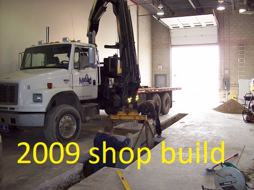

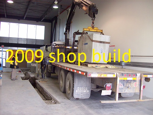

The 2 compartment catch basin sump arrives.
This I was bummed out... the equipment from this build somehow shrunk in size than I remembered of the 2009 when I was a kid.
The concrete cutter was smaller, the catch basin seem to be smaller by a bit, and the delivery truck of the catch basin is definitely not as impressive.
Even though these precast catch basins will have "knock outs" for piping, but of course you're not always going to have things perfectly in line. But it's pretty simple for the concrete guys to core a 5" hole for the plumbers.
Ok, now this part is starting to catch up to wasfast… This ABS pipe now will plumb to the trench drains by garage door. The water caught in trench drain, will go into first dirt compartment, then water will flow up in higher hole inside the basin into the second compartment, dirt sinks down again, then exit into the sewer tied into my unit.

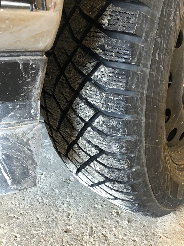

Hee hee, with our city, we have this saying (for those in snow cities using snow rated tires); in our city, we shouldn't change out of our winter tires till at least MAY lol... we're have some "nice days" but not holding my breathe (for Canadians in the 3 to 10 degrees, that'd be a wicked day for Feb) lol, in 2015 I think, I remember in January had a work trade show in Orlando, Florida and you can tell who the Canadians were in shorts and t-shirts, but it's considered winter over there; we were loving the pool at the conference resort too.
But I'm heading to California next week (one of these tri-state cities, I guess a little privacy ish)… for a week, to visit my first baby niece from older brother. So far she's a cutie pie in photos. (lol, obviously not my baby, so can't post)

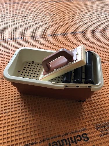

But, I am planning ahead, so that I can update GJ... I've already got 1,800 sqft tiles ordered lol (it'll take 2 weeks to arrive to my city, from their bigger Vancouver (Canada) headquarter; so flying next week for a week, ideally it should be good I'm coming back the same time tiles arrive to my local store)
So within these days before my California visit, I'm going to start Schluter Ditra separating membrane by the garage doors. Since I'm trying to get the garage door (front we'll call it) of the warehouse tiled... the back inner part will be left raw till the trades (framer, electric, plumbing; probably drywallers are done, and actual walls and corners and such are permanently in it's positions.

since you mentioned that most of the cars and trucks in your area might have studded tires til May how does the tile hold up when studs drive on them?
cheers
Actually, haven't had any visitors of the tiled Vaults garage condo roll in with studded winters. So, out of people with snow/winter rated tires, not all need to be studded. My truck's winter tires are just like this, didn't get them studded (need to do it when they're new mostly). So just a softer rubber compound, and the trend patterns.
But, I also think porcelain tiles will hold up against studded winters... haha, guess we'll find out with this 1968 cinderblock operational auto shop.

So I asked our building of 300-500 unit's super/maintenance for the dirty ones.
But why? Everytime doing mortar/thinset, even at best, I still need a small 4 Litre bucket to wash the towel, scooper, scrapper, etc. Sure, if I'm going for a long hard day's session, I'll use the previous mix's wash water to be my beginning water for a new mixture. But lunch, or end of day eventually comes or inevitably, just got to deal with that dirty water to dump. So at the Vaults garage condo, because they were still constructing, there's raw dirt pile that hasn't be paved that guys just put concrete, or other clean fill stuff back in the clay soil. Basically, I've collected these HVAC filters, just to try screening some dirt from filling up the catch basin. (there's still always a finger tip full at the end of the bucket pour, but I'll just garbage that as much as I can)
