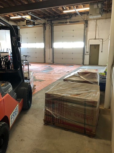

Here they are, my 3 pallets of 1,800 sqft worth of tiles for the 1968 Warehouse re-build/reno
So my order was messed, by 4 missed boxes being loaded. (came from their Vancouver, Canada headquarters so 1,000 km/ 625 miles from me) And my store's manager was just being considerate and professional, just calling me in (to pay) in one shot instead of choppy (oh we've got some pallets in, take some, oh, I owe you a few boxes come again, etc.); just easier one and done; but, I guess this isn't your average open to public big box store home department places. (been there done that, ordered lumber for fences, and it got so confusing)
lol, so I guess with this post, we know I folded and went with the forklift rental route. (next post, which will be today's update)
While at the tile store, called the forklift rental simultaneously with the tile delivery driver, unfortunately our city's economy and the current situation, things are slow everywhere, so it was easy to organize both parties. (I know easy is a good thing, but not the reasons behind it)
So with the odd ball 4 boxes (50 lbs each = 200 lbs) on a half pallet, the tile store just loaded to the back of my F-150...
It was an ahhhh moment, when they pulled their forklift out, I saw how even 200 lbs kind of "plunckered" the truck down a bit. And to think, each pallet is about 36-40 boxes at 50 lbs each (so 2,000 lbs); and I've researched my truck (and reading F-150 forums) members taking sod pallets, and specs does say it can handle 2,600 lbs weight. And even though it's a lease, lol lol; am I glad I folded for a forklift.

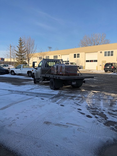

And it arrives, the main course.
So a little neat thing to write about, the reason why it's unloaded like in the photo, initially when I flagged the driver down, I was thinking he would just park on the driveway/stall in front of the bay door and I was just going outside to grab em. Of course, this guy knows what he's doing as a pro warehouse guy, says there's high chance the forklift will get stuck on the icy parking lot. It's always humbling to learn these little pro tips than failing the hard way.
Here's my driver's view (not operating while taking photo)
Notice only two pallets fitted their flatdeck, so driver had to get the 3rd pallet.

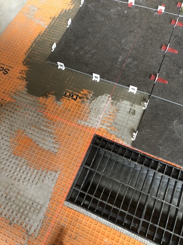

And yes, I know tiling is suppose to be centre/center of the room, but here's what I wanted to do... I wanted the steel covers for the 2 compartment sump (that you see in warehouses and car washes), I want mine to be the fulcrum point of the shop... So it's subtle because I'm incorporating it as if it's just another porcelain tile lol, but the rustic of them, will make these two "tiles" stand out. (I've gotten suggestions to powder coat them, get it bedlinered, etc; but combination of frugal, and believing no powder coat/line-x will prevent any coatings peeling once you start driving over it on a commercial bases; and it annoys me seeing that half paint peeling effect, so yes, I THINK I'm just going to leave them rusty)
Here's the first tile, so nervous. (so I lost my cool Bosch 90 degree tiling laser, had to buy another $60 Lowe's on sale Bosch "x" leveling laser just to draw straight lines, then Sharpie on the Ditra) I'm also lasering the distance from the sump covers, to the trench drain. (keeping in mind, they're probably not going to be exactly 90 degree of each other)…
Not many photos while I'm tiling cause when I get into "a bucket" (a 50 lbs thinset bag), wearing these surgical gloves, always watching my steps, knowing thinset has time expiry, etc.
Here's 1 bucket's worth
And this is how I ended my day, another 1.5 bucket. (so 2.5 bucket total, with forklift rental/return, tile delivery management)… I can see why and how general contractors has their value to keep everything organized through a project. (I just can't afford the 1 mega invoice shock of "Thomas everything is completed, you owe us THIS amount"; so I got to piece all this together, AND put in the work lol)

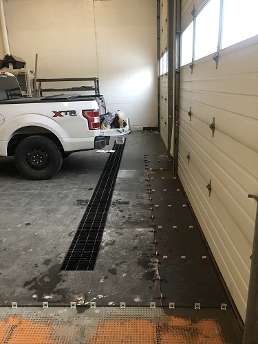

Day 2 spending on tiling at 1968 warehouse
Got my wet saw station setup, this thing at this point paid for itself (bought purposely for Vaults garage condo, before pulling trigger to do tiles here, I wanted to sell it, the waste in real estate (SPACE) for this thing annoys me)
But even something cheapo Princess Auto (i.e. Harbor Freight), with a quality Dewalt blade, can cut 1/2" trim piece off a 24" tile (can't do that with that slicer thingy, whatever tile guys call it lol)
Haha, ok this sentence is an embarrassing post. So my $200 Bosch 90 degree (specifically designed) for tile work laser that I got just to do the Vaults garage condo; ummm yeah, during moving **** around, I can't find it. And too lazy to toss the whole place to find it. (lol, of course I'm sure it'll show up once I'm done the entire reno on 1968) I'm so mad at myself because while sizing up/researching before tiling the Vaults (to do the very first tile correctly); I hmmm and uhhhhh thousand times whether I should drop $200 just to do ONE tile. (yes, you can use it continuously to check your work; I kinda half *** didn't use it after 20% was installed and some lines were going off, and hoped for the best during Vaults install)
So now I dumped another $60 at Lowes on this on-sale Bosch regular "X" kind of laser. (I'm sure it's only suppose to be for walls, hanging picture frames or wall tile)
Trying to rig this thing to do floor lines to cut a tile. Tried this cart, not stable enough
Then tried clamping on this 1990 era cheapo Black & Decker stand inherited from dad's garage arsenal of DIY tools lol (I sold my Walmart cheapo camera stand on FB marketplace last year lol, that would had worked perfect; but it was taking up our condo storage cage space)
BUT, it was a failure. I don't think it's the right tool (laser), the gyro keeps resetting, so the laser would click off every 2 seconds (like blinks), because my body was in the way. And somehow the "angle" where it's clamped, pointing to the floor, projects different "stretched" red beam if that makes sense. How I'm trying to cut the tile where the end grate is, so the tile is also raised up a bit, so this laser is throwing off wacky beams.
So what I ended up doing? lol... just a simple Sharpie marker, and my inherited dad's straight edge level, and just drew a line to mark my cut. (I know, snapping chalk lines, but I sold my chalk line tape on FB marketplace for $5 lol and I'm too lazy/frugal to get one for this project, don't ask why, sometimes if I don't see a frequent use for tools, I just don't want to have it in my possession)
And then worked on the tiles surrounding the sump catch basin covers. (I figure it'll take about 2-4 sessions, to let certain parts dry, then you can do the next, etc.) And of course, if I took a close up, it won't be 3/8" gap through out like pros, but did the best I could with non-pro tools, and DIY skills (there's a part at one side of the transition where the gap to grout is 5/8" :( the wet saw couldn't get the cut any tighter)
Ended my 10 hour day with grouting the dried stuff from yesterday's tiling.
Trying this $150 grouting kit bucket that's so popular, my verdict is, it does save your hands (grip) from constantly squeezing traditional sponge; however, for this brand, I had to press down on the handle really hard to ring out the sponge on the rollers, otherwise the sponge is still too damp and you're diluting the grout.
This is day 2 tile work as it sits
It's so depressing however, look at the PALLETS of tiles looks as if they're untouched. (so about 50 tiles laid, that's 12 box ish, but I barely made a dent in one pallet, imagine if the pallet would still be in my F150 lol)
This is all being used up in the first pallet. (i.e. because 4 boxes were in my truck, so that's 16 tiles, then on a certain pallet had 4 boxes on top; so that's 8 boxes.... then only using up 4 box breaking up the 1st pallet; to make the the 48-50 pieces laid) I guess 100 boxes (400 large tiles) to go lol

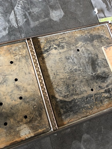

The middle part between the two sump steel covers, it's about 2" wide (yup, I did ask the flooring store if Schluter makes a 1/2" 12mm thick transition like that, naw, gotta build my own)
Needed a 1/2" width full 24" length tile, this little piece took a good 30-45 min to make. Since now I'm over cautious about my work ethics and give more efforts into my tasks (yeah, thanks dad, lol), I've already burnt my parlay.
When cutting a long 24", but narrow piece like that, it'll usually break. This piece took so much time, because I'm stopping (really carefully) this crappy wet saw a few times, and made sure the exit end is taped up
Here it is, tile for the middle between the two sump steel plating.
Stashed it way in the rear of the shop, so my moronic self don't get bored touching and breaking it before install
Now time for the trim piece for this middle sump part... (sold my dad's mitre box years ago), so now I'm just rigging these plywood pieces to prop the trim up off the table. Using hand saw vs. chop saw to prevent heat burn for this bronze/copper color (silver burn isn't as noticeable, I used silver at Vaults garage condo)… but back to caveman tools for this build, handsaw, then hand file the burs
Because of how narrow it is, the bottom of the trim overlap each other
Grinder cuts off excess pretty quick
This should work

I was putting it off, but I have to work on raising the 2 sump steel covers. Drives; I think I'm going to leave the "rustic" as a look. I'm wondering if powder coating will last, and once vehicles are driven on it, it bugs me if (if I paid for coatings) half peels... So I might as well for the time being go for the rat-rod look on these covers lol
Between the 1968 rough floors, Schluter Ditra uncoupling membrane, thinset spread, 10mm tile, I'd say the cover needs to be raised anywhere from 5/8" - 3/4", in order for the steel plates to be flush with the tiles. On top of this non-uniform difference, the "slab" (entire 20'x20' sections of concrete floors) in those days, they sloped it probably 0.5 degree towards the garage door. (i.e. in newer industrial builds, I notice floors being completely level)… and when they installed the sump, I instructed them to follow the floor, and not sink it in like when you go to a commercial car wash; annoys me working on a car on a "slope", it's like working on a hill. The end closer to the door is lower than the end to the rear, following the flow of the slab, but level to the slab.
Not really up for this challenge, but here's my DIY first time ever trying to make this work.
So I'm going to build a curb (if that's the right term), and fill he rim with leveling compound.
First, protect the copper trim. The cardboard pieces are for the inside.
This weird looking thing...
Because I want the inside to have some structure when pouring the leveling compound
Stuffed it with more cardboard (between the structure ring and the cardboard that's against the inside sump)
First session of pour. (I think it'll take 2-3 sessions to let it layer dry, than having a thick *** 3/4" liquid trying to dry)

Testing my 2 compartment sump cover raising, a cheesy depth gauge lol
Ok, fingers crossed, final depth pour... this is the 4th session.

Removing the first of 2 form for raising the two compartment sump lip with leveling compound, heart was pounding as I walked over with the rusty steel plate, hoping it'll go as planned.
And it works, sitting flush with tile surface.
Love shuffling my feet along tiles over the plate, so smooth. (well, as smooth as a DIY guy can get it; but casters, chairs rolling over, no problem)
Time for the second cover... this time with more experience (of doing it ONCE, lol)
But of course, motor skills got more efficient, taping off the copper trim
Some wiser tricks up my sleeves now... example, double row the tuck tape (in the first cover, 1 row and when the level compound got on the cardboard, it stuck)
Instead of stuffing cardboard in the gap to give pressure against inside concrete rim, use hot glue to seal it before pouring. (in the first cover, there was some leakage of liquid thru the gap between cardboard and inside rim)
Now I can claim to be the master of sump cover height raising.

(1968 cinderblock warehouse): Finally got the two compartment sump steel plates flush, so that part can be completely driven on.
Got the trench drain area, minus 1 last piece (between garage doors) to cut
Making my way towards inside of bay.. (I'll stop to where the mezzanine support will be framed, so about 15' from wall to inward)
