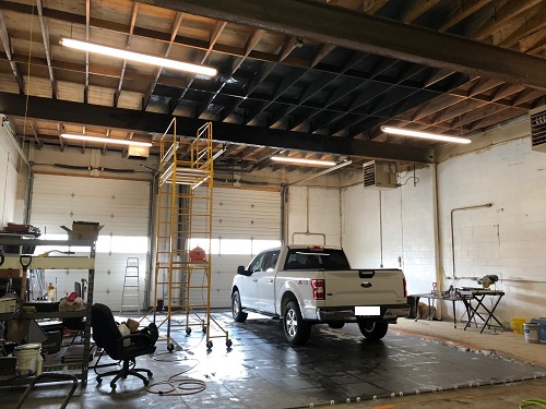

Just ordered a small handheld Graco paint sprayer... Gonna tackle the ceiling (just flat black "dryfall")
Did you get the last piece of tile in under the garage door rail? I was going to suggest that rather than fit the tile around the rail, just get your angle grinder in there and cut off the last 1/2" or so of the rail so it matches the others, then slide the tile under it like you did the other ones?
So there're 4 rails (between two doors)
I just did whatever was convenient at the time of measuring lol.. since I got the attitude that this is going to be used as a shop anyways, and not a higher end home or like a bontique garage condo.
So some, I was able to trace it, and hand grinder the curve; where the rail touches the ground
This one, the rail was really raised... so exactly, I just cut it with straight cuts, and just hand shaped the grout to make it look decent
One last piece by the mandoor, but I have to wait till a corridor hallway gets built, probably same lumber order as the mezzanine
I was dreading this task since moving in, so my second garage door was blocked by the intake ducting of the roof air make up unit. The last owner wasn't automotive, (furniture restoration) so he never needed both garage doors.
So climbed up on the scaffold, and grinded down probably 20-30 years of sawdust filled vent deflector.
Now I can have 2 garage doors in a small bay unit, there are hard to see nowadays. Usually bays are long and narrow with 1 garage door.
I'd say this $500-600 scaffold purchase will pay for itself during this reno. Gonna do the ceiling myself, or if trades (electrician) needs to use it, I know not as mobile as a scissor lift.

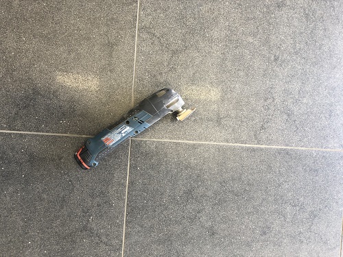

Urgh, so spent the day at The Vaults garage condo (mentally, I'm so out of there, lol)… but it was nice to see some of the familiar trades faces I've met there along these years, the drywallers, plumber, framers, etc. Social distanced chatted a bit with them, saw some garage condo neighbours.
So bought up a couple tools.
So when I was on the gung-ho trail laying tiles at the garage condo, I totally forgotten/ignorant about not having MOVEMENT joints. (expansion joints in concrete slabs, from what I understand, is separated by putting down those orange Schluter Ditre uncoupling membrane); but movement joints, if I understand the termology, is shifting of the tiles.
Thanks to the tile pros reading this and not busting me earlier.
So the thought of tiles popping, and not making an attempt to fix/or doing it proper just bugs me. Yes, the perimeter (against the walls) has 1/4" gaps (just like you would installing hardwood or laminate), but in the middle, I understand 20'x20' areas should have relief joints.
When I flew to California in February (before lockdowns of cities)… I was so in awww staring at the airport movement joints, with nice expensive rubbery materials
Kicking myself that I should had known better with all the informative threads on GJ from members doing porcelain talk about "Respect the Joint"... lol, I did not respect the joint at the garage condo, I'm sorry guys. (For the 1968 cinderblock warehouse, yes, I left 1/4" gaps, didn't grout, and went straight to silicon; just didn't cover the topic with photos)

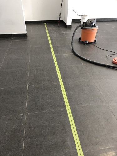

So that's not the case with the garage condo, so gotta pay my dues. Went back, and to use these oscillating tool with grout removing tool... did over 100' (24' width bay did two lines, and the length is 50')
So just divided it up in 6 sections... so hopefully it'll give it some space to breathe if needed.
$20/tube :( the manufacturer says color will get darker as it ages. Did 8 tubes at the 1968 warehouse (since it's 1/4" gap, and 3/8" deep)… with this, I removed the grout as much as my hands can handle these vibrating tools (getting old here), and it's only 1/8" grout line... so all this only took 1 tube. Hope it'll work, but at least I've thinned out and weakened the grout where movement joint is suppose to be.
Sorry pros, for missing this very important step at the garage condo. (again, for the 1968 warehouse, I've accounted for it, and didn't need to work backwards grinding grout, horrible task btw)

Where do I pick up that stuff? I think I should just fill in my cuts in the garage floor with similar but same time it’s nice to control water etc to the quadrants.
The place is called Shamrock flooring; they got two locations. South is by blackfoot. North one is McKnight (closest to you)
They got tons of colour choices. The color rite brand I guess custom mixes silicon to match grout colours. So see how my grout is “grey”, as I’m squeezing these $20/tube “custom grey” liquid gold, I ponder could I had gotten away with just using Home Depot kitchen/bath grey colour silicon instead. (Like different if you’re matching orange, lime, yellow grout or something)
I did silicon because I didn’t want to spend $$$$$ on those Schluter movement joint transitions, it’s so pricey

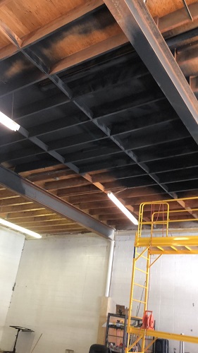

Well, I'm on the ceiling now... at least using this "stay home" (self isolation order) situation to get the BULK of the ceiling sprayed.
Got a handheld Graco. Yes I know, the suggestion is, why not just buy a big *** unit and be done within 1 day. Here's my answer: for the future, I can't see myself doing tons of spraying to need a huge 5 gallon pale sprayer, and two, for handheld, I CAN see myself using it more for small random projects... And I'm still actively trying to declutter. (i.e. the shop and work tools is one thing, that relates to work); but if I ever shut down my business, switch trade, move away from Canada, I'd like to think I'd still try to travel with 1 U-haul trailer to wherever I go. (even moving and starting fresh, sometimes you don't want to over bring stuff like table saws, etc... but handheld sprayer like this, you betcha)
The paint is just flat black, the product is call Dryfall (first time as a DIY I've heard of this; obviously pro contractors use this daily)… It's where if your commercial ceiling is over 15' ish (give or take), any over spray in theory is suppose turn to dust or easily wipe-able after 5-6'
To a pro, if the warehouse is completely empty... I can totally see pros with heavy duty sprayer, can get this done within 1 day, no doubt.
But here's another benefit for me doing it without timeless and bits and pieces at a time... I don't think I'd be able to withstand the smell of a full day's spraying of paint. So this is 1 "session" (really 2-3 hours, by the time I pour into the handheld cup from a 1 gallon can); these photos are about 2 gallons; so I think 15 gallons for total 2,000 sqft… 20 gallons for deep full coated (Dryfall product only comes in 5 gallons)
It's actually cool, after cleaning the handheld sprayer, then I'll add in little micro projects (will show you guys one tomorrow), without crazy paint fumes. Notice the vacuum on scaffold, at FIRST I was vacuuming the trusses, but after 1 cup, I'll be honest, I'm like screw it, just gonna sprayer over it. But maybe next spray session, I'll just quickly broom brush the trusses quickly. (Vacuum was too annoying)

Did a ceiling spray session today (I'd say spending 1-3 hours spraying, is good enough for me, the fumes even at low VOC's, and the dust and dryfall falling on my goggles) All the trusses are covered in dust since this used to be a furniture restoration shop for 30-35 years straight. (instead of vacuum, I'm just broom brushing anything down before hitting the sprayer; seems like this will be the only trigger action our country will be getting for the coming future)

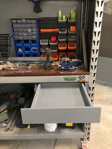

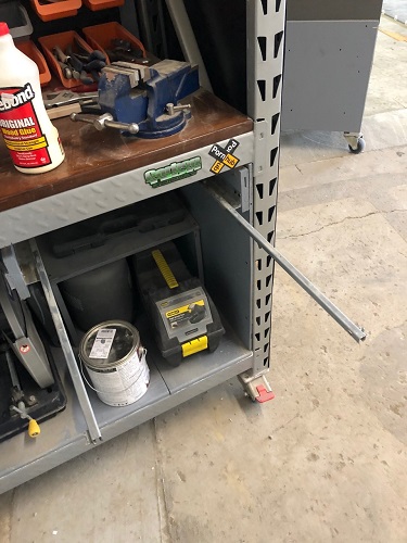

Here's a mini project I'm also doing, out of the 2 big rolling steel shelves, testing out building a tool drawer. Everything is REPURPOSE, and laying around.
It's funny, few months ago, I got rid of this cool (store bought, plus vinyl wrapped professionally) tool chest as I've cleared out the Vaults garage condo (lol, no action on that real estate property still but oh well)… But I also can't see myself needing a crazy *** tool chest, sometimes these things get in the way. (for the 1968 warehouse auto appearance shop, need the square footage for more vehicles, or bodypanels being removed to be worked on)
So drawer tracks, and just jimmy-rigged the support for it with random plywood.
And then slap a "facia" on, lol... it's so damn cheesy, but I'll build another one on the other big shelf, so it'll fit more stuff; both of these shelve/work bench, I've outfitted with just common basic tools: wrenches, driver bits, sockets, etc. it's good enough for the industry I do. Don't forget, I'm planning on having a business operation in this 1968 warehouse; and sometimes I might leave the subcontractors or employees at the shop by themselves, and I get pet peeve leaving unlock toolchest to anyone (regardless how cheap my tools are), I hate anyone messing with the way I organize MY toolchest (reference why I sold my decent looking store bought tool chest)
Also a fun reminder, even the drawer slides for this cheesy drawer micro project, is repurposed. Not expecting anyone remembering old posts, but last year when I reno'ed my downtown small condo unit... a friend was throwing out their entire Ikea closet (boards on bottom were rotting/soaked with winter slush)
With the shoe drawers repurposed as wall shelves at the condo
That's where I got my "free" drawer slide for this my current 1968 warehouse work bench drawer project lol... just some flimsy Ikea slides, didn't even spend the $20 bucks at home depot for decent industrial slides. That's how weird I am sometimes
This is session 2 of spraying with a handheld sprayer.
Yes, I know, a real Pro's ONE-day job... I'm probably gonna drag this out into 20-30 sessions lol. To be fair, I have to constantly move my stuff, then I'll plan stuff, then I'll do some stuff with micro projects, etc... I guess just something to do without living in a suburb house with home maintenance stuff.
