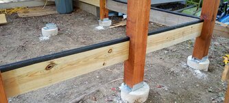

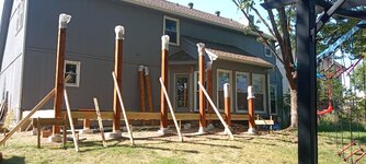

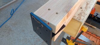

Looks like a great project. Currently working on something very similar. Will also be screening the porch in. Thinking of using netting on underside of joist to keep bugs out. Will install synthetic decking on top side. Triple flashed ledger.

Yes will be doing some research this week also to find a good product for the floor. Also think about the cheap builder wrap that is similar to synthetic burlap.

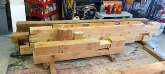

It's been a year... thought I'd be farther along by now... but I'm still cutting the Timber Frame 🙃
Spent more time sorting out my cut list than I intended, and then had some twigs warp on my and need to be replaced. (had to tighten up my order details with the sawyer to require box heart or no heart).
Here's some more pics to show I'm actually getting something done.
Took a while to detail all the joinery and generate prints for each stick.
and make prints
Loading up logs to take to my buddy with the Woodmizer (one of several trips)
I helped tend the mill when slicing up my logs... but couldn't fill my cut list, so had to buy timbers cut from his log pile (big Pine and Spruce)....
And coming back with the goods...
