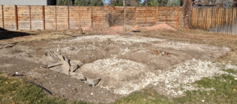

Only about half the footprint of the building had concrete so we didn't think it would be too bad. On the 2nd day of demo, we rented a jack hammer from Home Depot and started breaking it all apart. 3 of the 6'x6' pads had chicken wire as reinforcement which really slowed us down. Had to break it up and cut out each section with linemen pliers piece by piece. 3 other sections around the perimeter didn't put up too much fight but the original main structure threw us a curveball. It had 3' footings all the way around on a 10'x10' structure plus a chicken wire reinforced floor. We were running short on rental time so we broke up everything we could on the surface but didn't yet know about the deep footings.
After the weekend was over, I booked 2 more dumpsters. a 30 yard and 15 yard heavy for the concrete. I spent my spare time finishing up the chicken wire concrete demo during the week and nursing blisters. The next weekend I loaded those 2 dumpsters to the brim. I rented a jackhammer again to take care of the footers. I still had to lever the big pieces of the footers loose with a big pry bar. I was pretty wrecked after these 2 weekends and I was also in the middle of training for a 100 mile bike ride the following weekend. My wife even felt bad for me enough to come out and help move the last of the concrete.

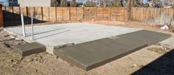

Day 7 (Monday) - Final concrete work
Workers got here pretty early again to do the final apron work. They ordered a concrete truck that was scheduled to arrive at 8am again and they still had to remove sections of the original form from the apron area and build out the service door apron form. Instead of pumping the concrete, they were able to run back and forth with their front end loader's bucket to move concrete from the street to the site. It's only a 4" pour on the garage door apron.
They spent the rest of the morning cleaning up their blankets, removing forms, and doing the saw cuts. They matched the saw cuts in the new concrete by hand with a hand tool. It was in the low 60s here so the apron concrete probably required less special treatment. They were able to remove the forms around the aprons and head out by 2pm. Here's the final concrete work.

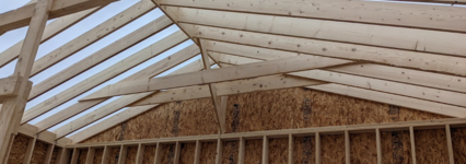

Day 23 (Wednesday) - Full Structure
Framers got to work today. It was a high of mid 30s with snow predicted to start around 3pm. I think I overheard they were having some troubles getting their compressors going this morning. They might have even put them in their van for a while to heat them up.
They made a lot of progress today. Got the main roof structure on and almost all the vertical OSB up. I knew it would be tall, but seeing the structure at full height makes it seem so much bigger. It looks like a 2nd house when looking from the street. When standing inside with full walls and height, I can start to visualize where everything will go. I asked them to get a new door since the one they had would open inward and to the left. That seems like it will just waste space doing that. I guess doors for 2x6 framing aren't totally common so we'll see if they can get that sorted soon.
They only got 2 ceiling joists up before the snow started. I thought we had settled on 13' ceiling height but it's just under 14' to the bottom of the joist. I know we were talking about putting it up as high as possible to minimize the wasted space at the peak of the roof so maybe this is what we settled on. The only down side I can think of I might need to rethink the layout of the lights on the ceiling.

What is your roof pitch?
I'm interested on how high those rafter ties (ceiling joists) are. I thought IRC only allowed the joists to be in the lower 1/3 of the rafter height. Maybe its the pictures but they're looking a little high for that.
The roof pitch was spec'd to be 4/12 originally. We did have to get an engineer involved and sign off on this design of raised ceiling joists. Their involvement resulted in 16" spacing and a change to 5/12 pitch. I'm not sure what to say about the lower 1/3 limitation other than this plan was approved by the powers that be.
from the engineer's design letter:
Joists: Install 2x10 @ 16” o.c. HF #2 ceiling joists that will attach directly to the roof rafters 2’-3” above the stud wall. The span of the ceiling joists will be 17’.
If it's spec'd then I think you are A-OK and the extra headroom will be nice. Based on how high they were, I was wondering if the ceiling joists were only 16' long, which would have saved money but been insufficient on their own.

Day 26 (Saturday) - Final Framing Work
I didn't realize the framers were coming back today but they were here at 8 am. They did a lot of little clean up work that really makes it look more polished.
Overhang over the front and rear of the building were finished. Fire block pieces all installed. Windows in.
There is one piece on either side of the ceiling that I don't think should be there permanently. It sure would complicate the drywall. I circled it below. Other than that, I think it looks great. I'm definitely going to need a bigger ladder and I want to think of some good uses for all this extra wall space up high.
Sheathing inspection should be Monday.

That extra piece of wood on the back wall looks almost like a piece of wall bracing where it ties into the top plate there. I'm betting it goes all the way up to the peak of the rafters? It could be required by your structural engineer for the ceiling diaphragm for racking strength on the back wall. I would double check with them if it can be removed or not. Typically gable walls like your back wall can be braced with the trusses flat across the bottom with drywall and some 2x4 runs across the trusses. Because you have a vaulted ceiling there is nothing but the sheathing to stop the wall from buckling right where the truss meets the top plate. There should be some work-arounds to be able to remove that piece that could be discussed with your structural engineer.
See below:
