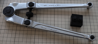

I've been doing a lot of bearing replacements, so I picked up a nice adjustable pin spanner as I've often been stymied by spanner nuts. It came with two sets of double sided threaded inserts to support the 4 different pin diameters, but made they no provision to store the loose set with the tool. I had seen used units advertized, all of them missing the extra pins.
So I made a little block with form fitted slots in the sides that fit over the legs of the tool and threaded holes that allow me to securely store the spare pins. With the legs clamped on it, they aren't going anywhere.

I would expect a lot of you know the name, famous over here for toilets, bathrooms and housewares. But that box really seemed an odd thing to be TOTO branded, curious I clicked through. To my complete astonishment, what was revealed was that this was a pair of white ceramic v blocks! What? WHAT?
I did a few quick searches, I had no idea that TOTO had ever made anything like this and got zero results. There was nothing. No hits on the model number. No historical hits on Yahoo auctions, no stores selling them, just no hits at all. So they were either very old (pre-Japanese internet) or very rare, but likely both? The price was a no brainer, they looked intact and little used so I bought them straight up, even if they weren't what they appeared to be, I love me some rare knick-knacks.
Once they were purchased, I continued to dig knowing they were safely on their way, and discovered a dead link to the TOTO advanced ceramics group. No wayback machine, but the Google Cache still had some text I could translate. The page primarily focused on custom semiconductor and LCD display fabrication elements, how they used their unique advanced ceramics for some of the most precision components used in those industries. Things like giant air bearing support elements, electrostatic chucks (for manipulating silicon wafers) and components that leverage the incredible stiffness or thermal properties of the various ceramic formulations they created.
Oh, and they also made a limited line of ceramic meteorological tools, only lab grade, made to order, and if you have to ask the price... no one buying these were doing price comparisons.
They arrived this morning, and hidden under the foam in the lid of the box was the factory certification, showing all the critical measurements of the blocks as they left the facility. Being ceramic, they are incredibly wear resistant and stable. The Japanese are always ridiculously conservative when doing these sorts of measurements. Those numbers are in microns and I would bet good money that every error was at least doubled before recording it on this sheet. That's just how they roll over here.
