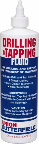

We use stainless exclusively and I find I have pretty good luck using Union Butterfield Drilling & Tapping Fluid. We also use Tap Magic but personally I prefer the thicker stuff. It seems to stay put better.
