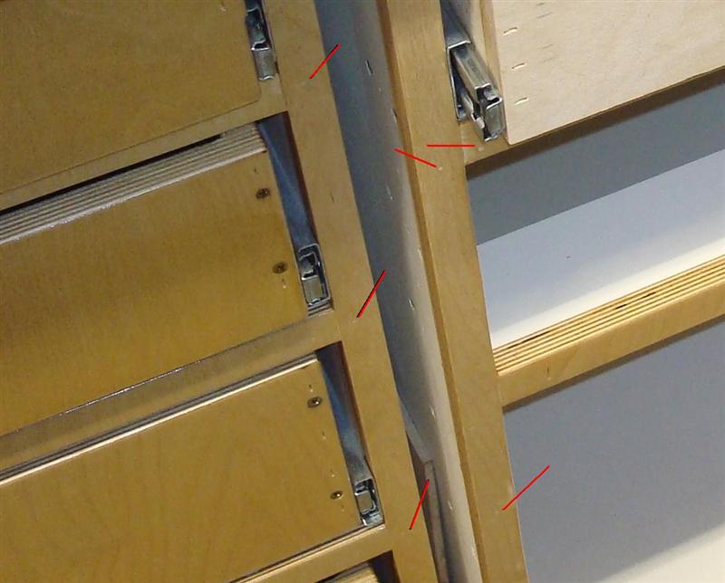

Pocket screws are a nice way to join a pair of boards together however there are two problems with plywood. First, when you attempt to sink the pocket screw I found that many times it separates the plys and essentially blows out. At that point you either pitch the board or have new finishing problems/considerations. I started down the face frame path and built one complete cabinet using them. In fact, this cabinet has a full face frame and isn't a facade.
After building this particular cabinet I realized that, though nice, building real face frames was going to be the longest part of the process. By going to the facades, I was able to do the construction part of the cabinets in 3 weekends if I recall correctly. Finishing was another story which ended up taking months considering three coats + dry time between coats + real job + family mad because they wanted attention.

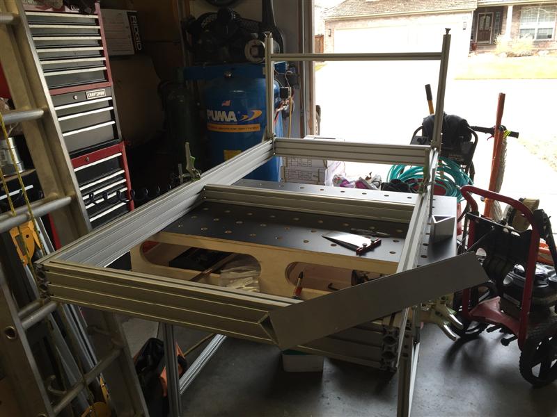

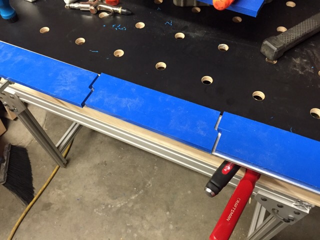

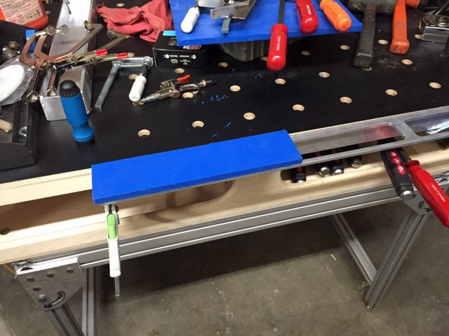

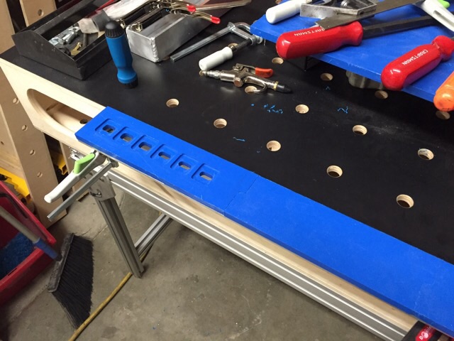

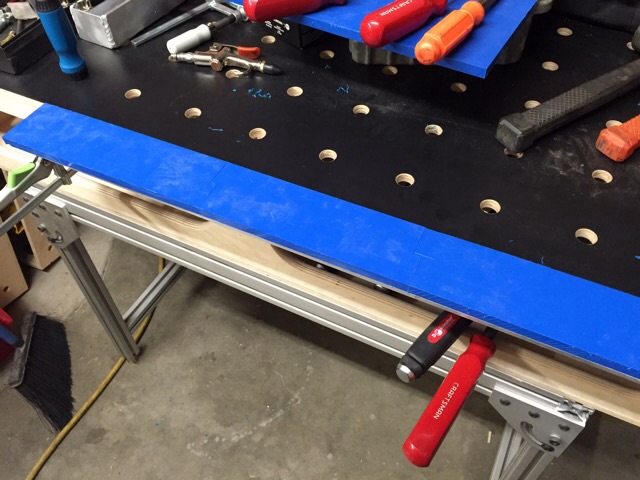

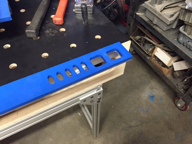

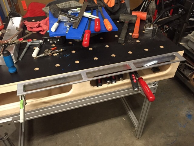

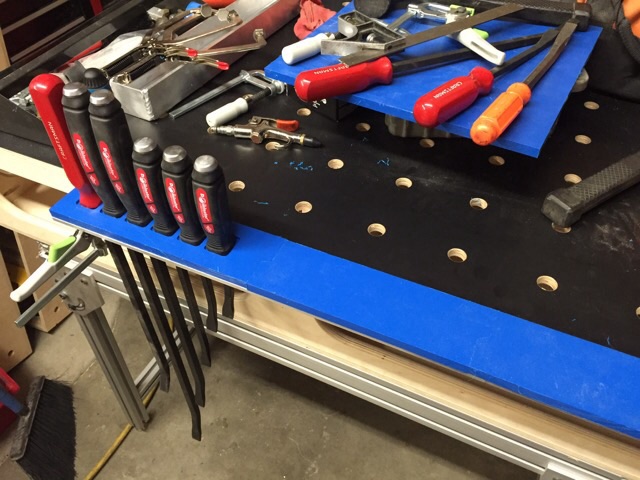

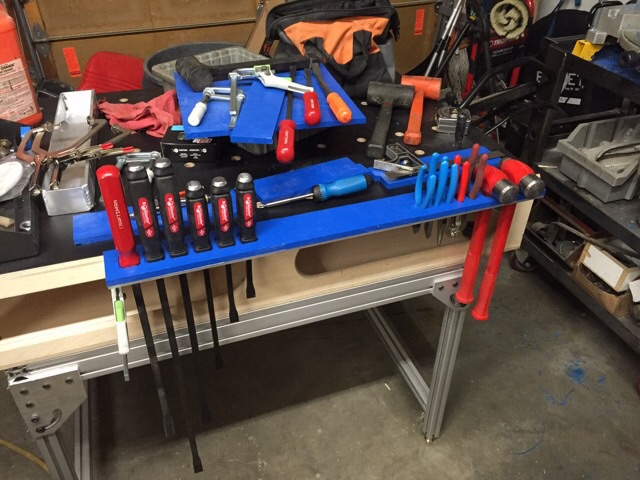

I've been away for some time now and failed to update like I should have which leaves me with a lot of work to catch everyone up. After cutting the pliers tray (a page or so back) out of HDPE I got into my next organization project to make a tooling rack for my shop cart. What I basically wanted was a shop cart caddy that would allow me to hang my tools off the side instead of laying them in the cart. What I found is that when using my cart I'd always have to lay parts on top of tools and then need to get the tools out from under the parts. Dumb I felt...
The base of the caddy is a piece of 1/4 x 3 x 3 aluminum extrusion I got off of amazon (I think). I cut there evenly sized slots down the length of the extrusion.
cut some 16-inch x 3-inch pieces of 1/2-inch HDPE out of some scraps I've been saving. Three of these pieces will connect and turn into the surface that the tools will go through.
The ends are machined so they interlock. Though this wasn't necessary, they fit together to make a much cleaner and upped the fancy factor a little bit.
When pushed together the three pieces look very much like a single piece which was what I was looking for.
First piece is machined for my pry bars which created the initial need for the caddy in the first place. The longer of the bars don't fit in any of my tool box drawers (mostly because I've chosen to be cheap and stick with my 26-inch wide box). I machined recesses so that the handles would self align and prevent them from rotating slightly in the slots and looking messy.
There's plenty of room for the prybars I currently have but not quite enough for the others that are on the way. :)
I also wanted provisions for pliers and hammers so they can quickly be accessed and put out of the way when using the cart. After taking some measurements I settled on the larger tools and machined them in the plastic. It took me a couple of attempts to adjust the profile for the pliers given how different most of them are.
After loading the hammers and pliers I take a step back to see how it's coming along. I could have moved the tools a little closer together to conserve space but after pulling tools out to see how it works I actually like the spacing because it makes it easy to grab exactly what I reach for.
What's interesting at this point is I'm not sure what I want to mount into the middle space. I've considered ratchets and extensions...that's when I hit the wall with some ideas that will ultimately cause me to start completely over even before I finish. I realized that I could have made the HDPE pieces much wider than the aluminum which would have allowed me to hang additional tools off the side like my extra long 1/2 and 3/8-inch extensions. I also realized that I won't likely want to store my shorter pry-bars on the cart year-round since they also have a home in my toolbox...****. Neat idea but this will have to be Rev-1.

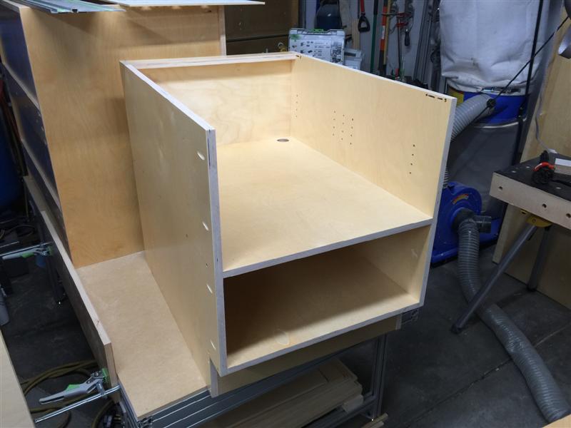

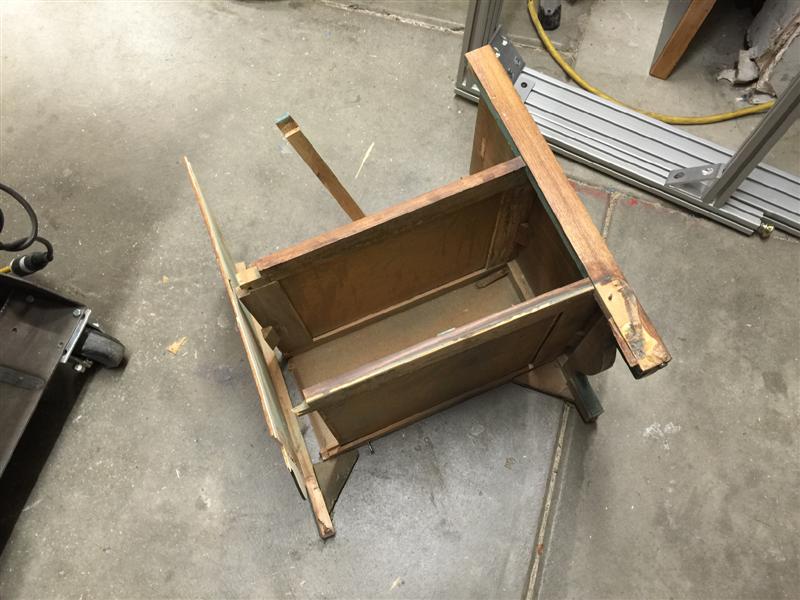

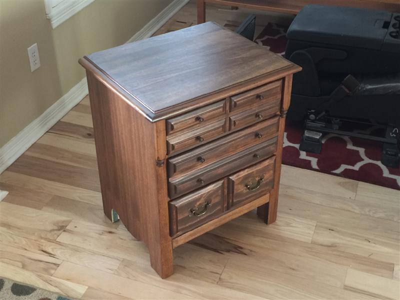

As a subtle reminder - I tend to have a dozen or so projects going at any given time so I'll jump around a little...I'm thinking now that maybe I should have named the thread organization in general because I'm about to take it inside for a bit...

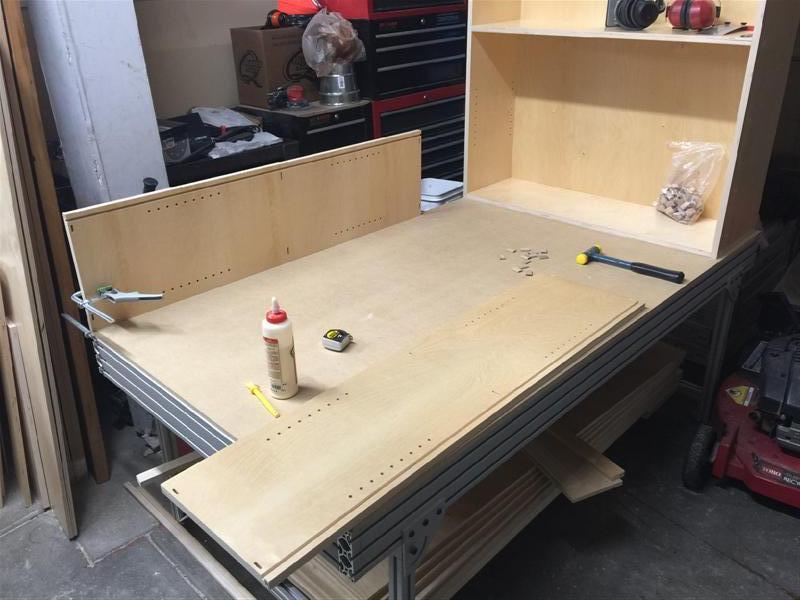

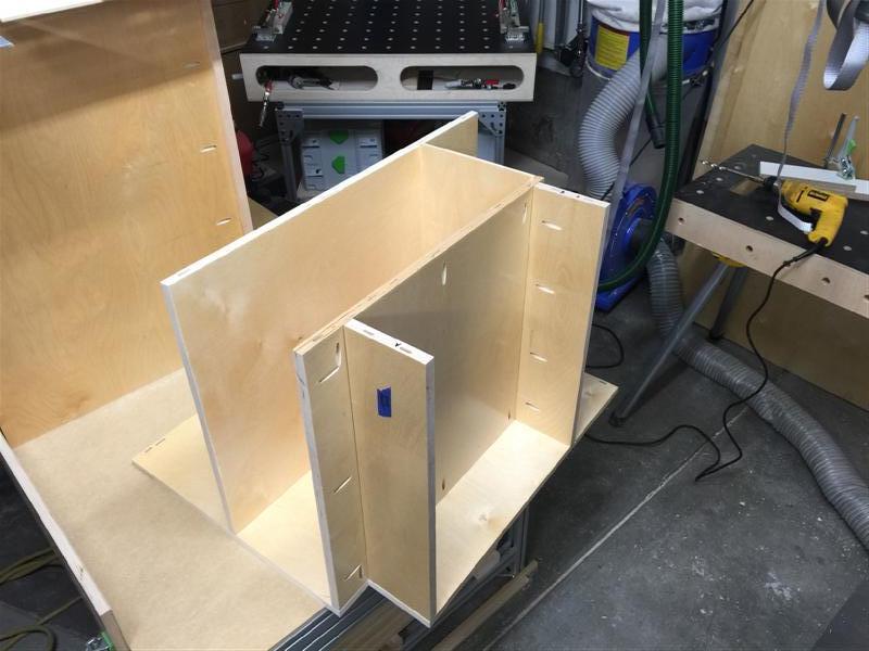

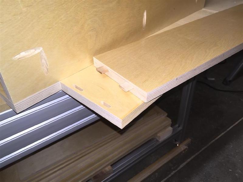

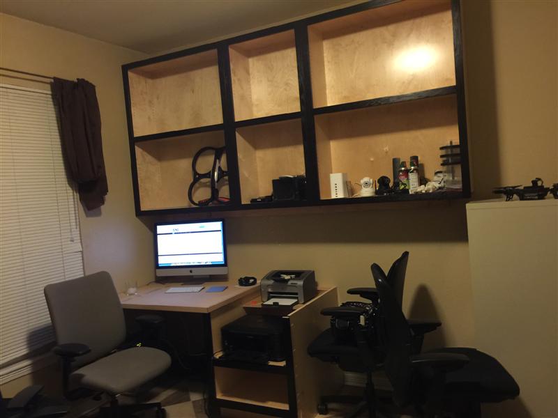

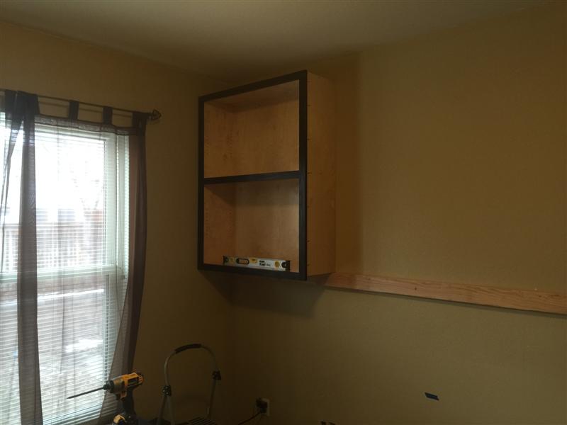

For those of you who have been following along for a while you know that I previously built some cabinets for the shop (some/lots). Some of you had asked how I went about making them. Though they were true face frame cabinets, they were made on the cheep using plywood for the face frames and gluing/brad nailing them in place. I did this because, at the time, I hadn't really been patient enough to learn how to build them the right way. If you really look close, you can see the filler for the brads.
Building cabinets the easy way in the garage was entirely different than doing so in the house. The primary difference was my wife's opinion of nice. "If you can't build them like the store makes them then I'd rather buy and have them today."
If you've been following along with Gregor's thread you've probably noticed some fairly nice looking woodworking tools known as Festools. The rage/addiction isn't much different than SnapOn (for those of you gear heads) but quite a bit different in magnitude. Imagine a company spent all of their R&D time trying to figure out exactly how they could build a series of tools that worked together and made projects with them many times less complicated -> well you don't have to imagine, you need to buy Festool if you're into woodworking (I'm not paid by them though I wish).
After much research, my first purchase was a track saw. Now I have a really kick *** table saw but I quickly learned that a good track saw can do so many things a table saw can't. Basically it's a circular saw on a straight edge and the possibilities are endless. The first project with my TS55 was to cut down a 5 foot tall under wear dresser (common about 50 years ago) in half and turn it into a night stand for my daughter. With the track saw it took only a few minutes and the rest required a little scavenging from the remnant parts to rebuild the base. I wish I had a before but in my haste to get things rolling I forgot to snap a before. Here's the bottom half (or what's left of it)
And here's the finished upper half (now a complete night stand).
It probably only took me a couple of hours to complete the conversion. What I hadn't anticipated is my wife's reaction to the completed project. Basically she realized I can build stuff for inside the house too. Stuff that looked as nice, if not nicer, than stuff we'd purchased for excessive dollar amounts in the past.

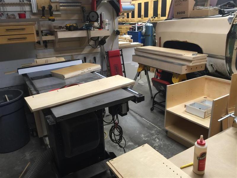

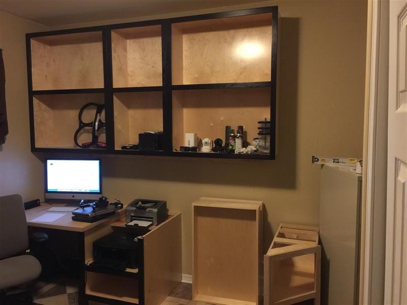

That night I was sitting here at my desk catching up on Gregor's thread (Mid-Century Moto Mecca Makeover) when I realized my office is a dump. Big desk (big for me) but we'd let junk piles accumulate everywhere. We had tried in the past to clean up but the space just wasn't enjoyable so piles would quickly return. It pissed me off. I'm seeing Gregor turn his space into something of a masterpiece when mine is a dive. I had always believed my shop was my refuge but like it or not, I had just realized that my house was where I spent most of my life. I walked out into the living room and told my wife I'd had it and we're about to remodel.
I spent about a week researching processes and found a fairly interesting tool called a domino (made by Festool). Basically it's machines loose tenon slots into material but in the convenient size of a biscuit joiner -- for $800!? Holy ****...that's some coin. I read maybe 2 dozen reviews on them and spent a week alone watching videos and research on how they work before I broke down and bought one. This little bundle is about $1300. It's a dust extractor and the domino on it's way home.
Before I could start building the cabinets I needed to wrap up a project I'd started many months prior which was the large assembly table (aluminum extrusion table similar to the much smaller, Paulk inspired, MFT that's under it in the picture).

In the shop I used 3/4-inch Baltic Birch ply and sprayed it with poly. After reading some posts I decided to make these cabinets using some pre-finished Baltic Birch to see if the prefinished stuff would save me some time.
Having finished the first lower base cabinet I changed my plan and decided to get all of the upper cabinets done and hung first so I'd not have to work around finished lowers. With the confidence of a now known process I machined all of the pieces first and then assembled all of them at once.
The office was to consist of a grand total of 5 48-inch tall x varying width uppers and two angled uppers for the ends (I'll show you later). With all of the machine work done, I started the assembly process. Here's where the larger assembly table really pays for itself. Because of it's height, I was able to do all of the work standing up instead of hunched over.
I used my peg board drilling jig to drill the shelf pin holes in the upper cabinets. The pins in the plate lock tightly in the holes in peg boad which allows me to drill holes as tight as 1 inch apart.
Then each board was grooved in the pack for a 1/4-inch panel and they were ready to assemble.
Here's where I didn't do too good a job documenting the build. I failed to get a single picture of the face frame construction but maybe it's a good thing - over the course of building the cabinets I changed a few things to make them easier. I'll document a frame at some point in the future so you all can see how easy it is.
The face frames are made out of 3/4 x 1 3/4-inch Red Oak and they're stained what's supposed to look like espresso. After the 2nd coat it started to look black unless you can get it into the light. Unfortunately there's not enough direct sunlight in that room so they're going to look black.
So a few things to point out about the above picture. First, I use a 2x4 to mount large upper cabinets on the wall. Using such a support allows me to (a) get them very level and (b) be able to easily support them with one hand while I climb up and down the ladder with the drill to fasten it to the wall. If you use this trick, make sure the 2x4 is straight or you'll end up with some visual fun. Didn't take long and I had the entire wall setup as well as the first base and a make-shift top. The office was usable again.
In the bottom right corner you can make out the first of the end cabinets which I built next. This cabinet serves as the right side of the base desk and has the same angle as the entrance to the office. It was a really goofy cabinet to build and took maybe 3 times longer than any of the other bases because I had to do all of the figuring for the first time as I was building it.
What a difference the pre-finished ply makes in building cabinets. The finish is super professional and the reduction in labor makes the less than $10 more per sheet seem almost a no brainier considering the time it saves.
