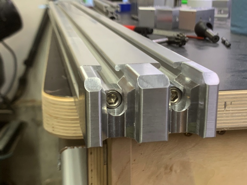

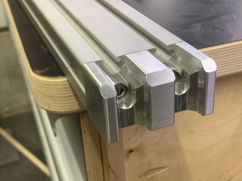

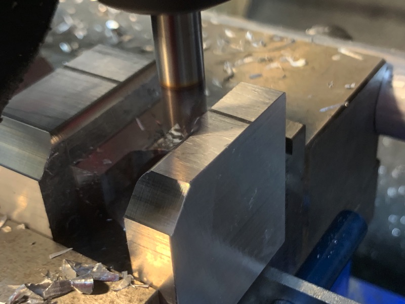

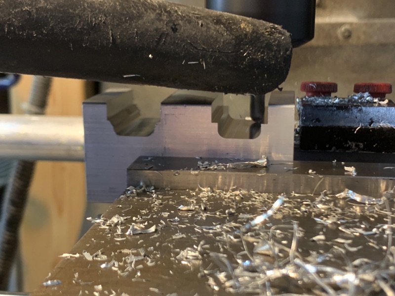

Ok, can’t live with the surface finish issue. I want back to the profile and looked at it again. The root of the slot is square not round like the ball mill. On either side there’s a subtle transition to a 45* angle that matches almost perfectly with a 1/4” ball mill. It then transitions another 45* straight up but square (no radius in transition).
I had a 1/4’ ball mill so I tried to copy the profile exactly. The root of the profile is almost exactly 3/8” so I used a 3/8” end mill to form the bottom. Before cutting the 45* angle, I just barely nicked the walls with the 1/4” ball mill.
There are moments where I try too hard to be too custom. I probably wasted a handful of hours and really accomplished nothing (except turning a piece of aluminum into junk). The left profile is what would be the completed one. The radius transitions from the root of the profile into the 45* angles are too wide and don’t line up well against the 80/20 profile. The radius transition also needed to start sooner. Though the clamp goes into the profile easily, it does now interfere with the 80/20 piece. So to hell with the 1/4” ball mill. I tried cutting the last one without (3/8” flat root and 45* walls) and wouldn’t you know it, it matches up so close to perfectly to the 80/20 profile it’s done done.
It’s difficult to see in the picture but those faint light spots in between the two pieces is where I used a deburring tool to soften both edges. It actually transitions between the two pieces almost perfectly without mis-alignment or interference in any way.

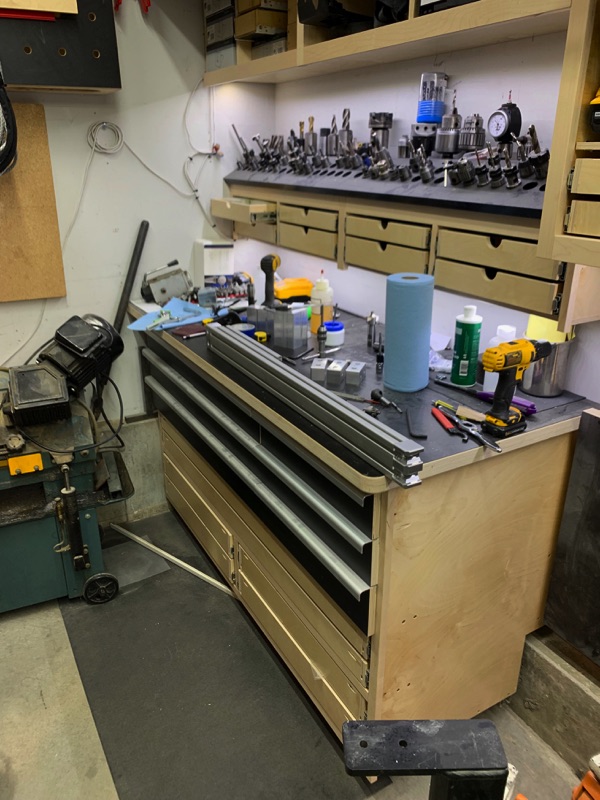

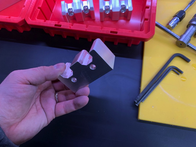

Walked back towards the bench and thought I'd share - in many of my shop pics I show an in progress mess. Here's the bench in usable form.
With these benches attaching to the wall, there’s no need for the fancy corner pieces on the back of the benches. These pieces were by far the easiest to make.

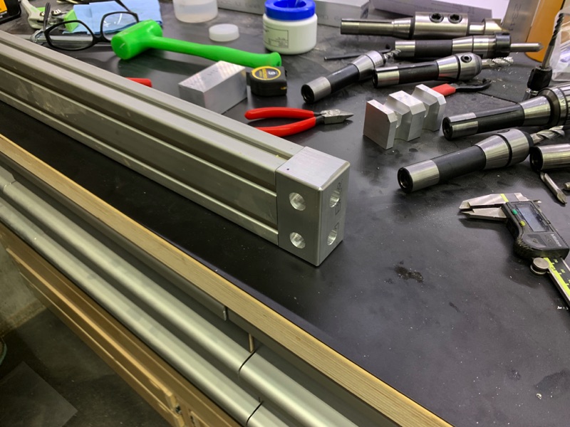

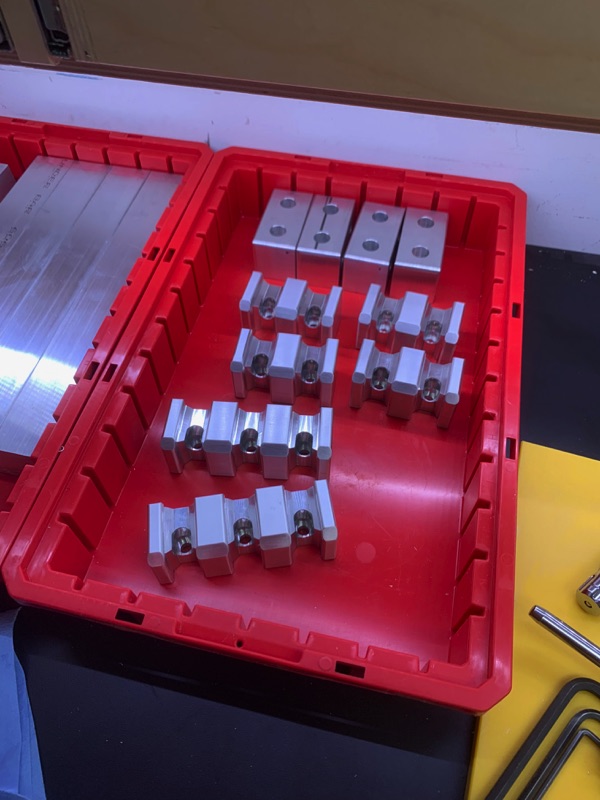

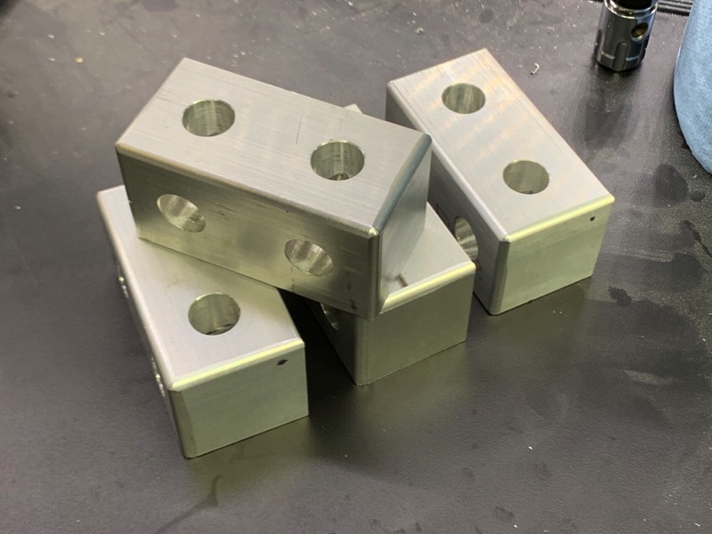

With the part now ready to go, now I just need to run duplicates. I decided I’ll make an extra set for the 1530 extrusions so I’ll have a set on the shelf waiting should I want to build another table in the future.

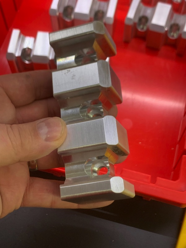

And 3 more of the front corner brackets. After the machining is done, I clean them up in soapy water and a scotchbrite pad. The slight abrasion does a nice job cleaning up the micro-scratches that chips can sometimes leave in the finish. It also every so slightly and subtly breaks the edges that we’re rounded over. On the left is freshly machined, on the right is one I’ve ‘cleaned up’

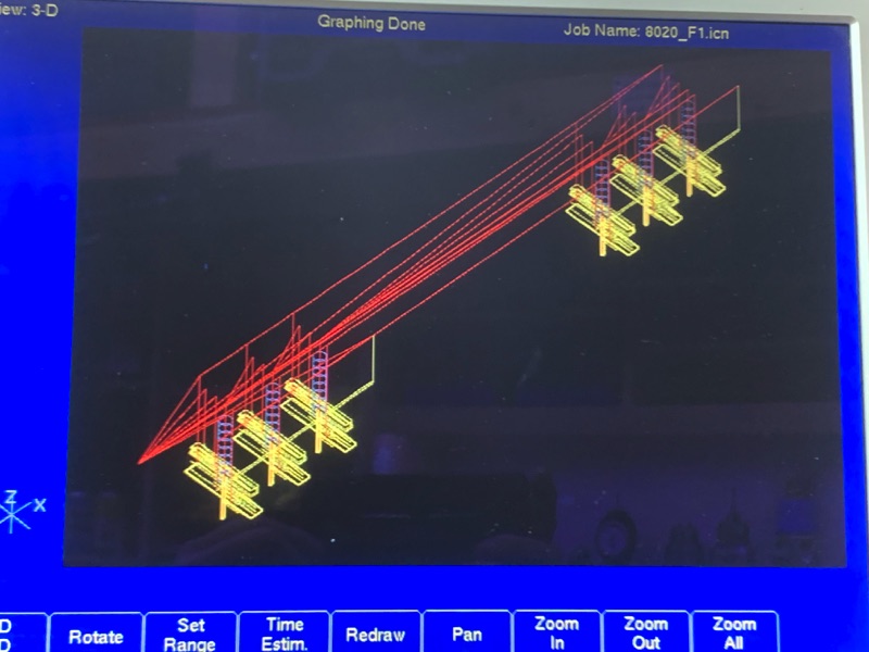

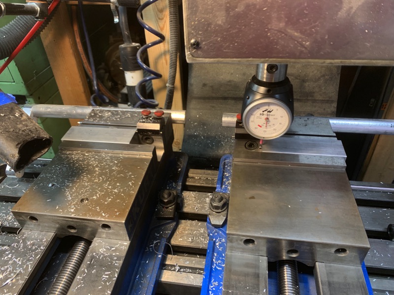

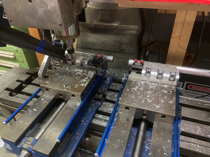

Now to machine the set for my existing 1545 bench. Ever hear of a 1-2-3 block? Well these would be the 1.5-3-4.5 blocks. The stop was previously set for 3” long parts and I need to move it back to fit a 4.5” long part.
After facing the rest of the bocks, I made a few adjustments to the cad file so I could run multiple parts at once. Measure the distance between the 2 vises - 12.5". Add a "Repeat” function right before every tooling change and enter an X-offset of 12.5”. I always pre-view the program in 3-d when setting up duplicates to make sure that I didn’t miss a step somewhere.

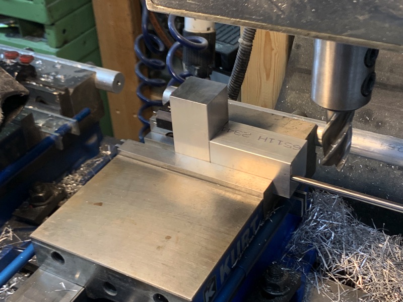

Move to position 0,0 and then x = 12.5. Now I can back the material into the gauge until it's zero, clamp the vise down, and I've got exactly 12.5" between the parts. This would work exactly the same if you had a DRO by the way only you'd move the table to position 12.5,0 by hand.
Now here's where having a CNC really shines. Cycle Start and everything it does on the first vise is repeated on the second.

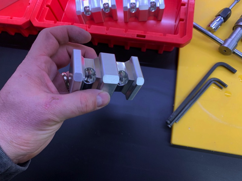

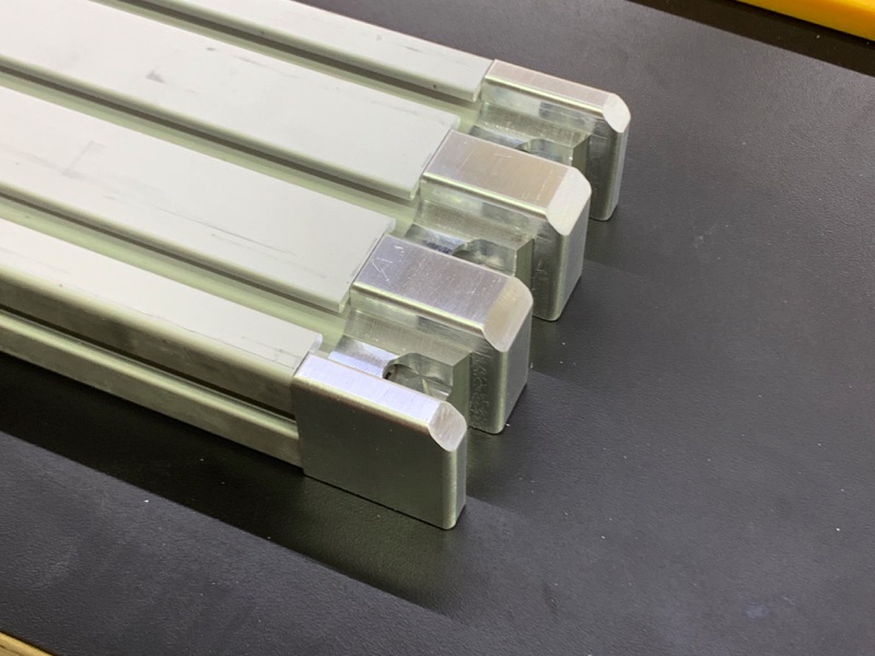

Second to last op - rounding the edges over with a .125” 2 flute quarter round bit. This is my favorite step. Run the bit at about 2400 RPM and it leaves a very smooth surface finish in a single pass.

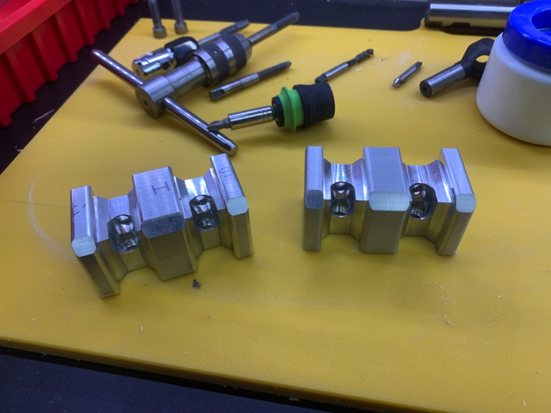

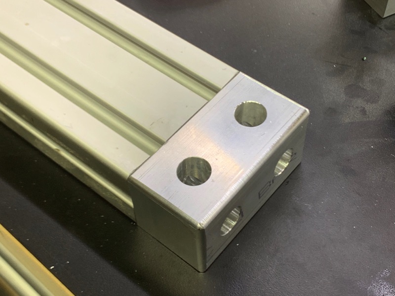

And the finished part - a 1545 corner. I'm liking the profile much more than the way it looked with the ball mill.
Test fit

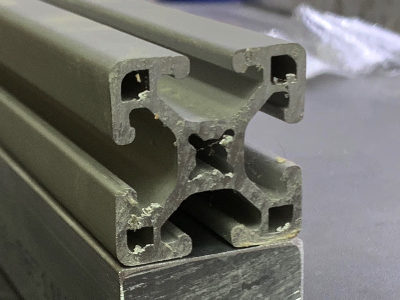

What I’d really like to do is put together one of the benches BUT I realized that the two bolts I’ve been using are the only two I have. I’ll have to order 60 of them and wait until next weekend. I’ll need to cut the rear two blocks but I’m getting very close to wrapping this one up. Parts go back in the bin, bin on the shelf, and that’s a wrap.
Grant Gunderson
May 17, 2013
2,351
Bellingham, WA
Would it work to just miter the two pieces of 8020 then do another 45 degree cut to break the outside of the resulting 90 degree angle? You could then join the two pieces using the slots on the inside of the corner. Maybe I am missing something?
L
lilscorpion
Mar 15, 2010
3,626
Colorado
You could, it would give you access to both t-slots but the voids in the extrusion would leave the end looking unfinished and exposed edges may snag on clothing, grab power cores of tools, ext.
To be completely honest, I’ve already skinned this cat. I cut slots in the extrusion faces to allow the clamps to slide in. I didn’t like the way the exposed end of the extrusion looked which I could have mitered/45’d them together or just made a cap. Either would have been far less work but neither are as fun. I really like the building process and especially when I get to make batches of parts. I’m not convinced I know why I enjoy it so much other than it gives me something to hold in my hand that I’ve built and watching the CNC make multiples is really cool. I don’t need a CNC lathe but I really really want one.

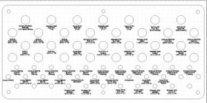

I’ve standardized on this style tooling trays. The basic design came from a vendor I’ve bought a lot of specialty router bits from. I’ve varied the theme to suit my needs.
Clear acrylic is engraved on the underside, then a layer of black acrylic, short standoffs and bottom layer of black. All relevant info is there for each bit.
These a fantastic!! I've seen your posts before and I spent about half an hour pondering if I should go after something similar but I didn't have any clear acrylic and I'm not yet confident enough to dive in on machining it. I've dabbled with single flute cutters a bit with okay results but nothing that finished this nicely. I've also watched a few videos about machining the stuff but I tend to stick to what I know. I have some setup issues too - I haven't solved for the engraving element on the mill yet. Part of the problem is RPM. Max on the mill is ~3k but you need nearly 3x that to run a true engraving bit. I tried once and I ended up snapping off the very tip of the tool because the feed rate was just too fast for how slow the tip was spinning (dragging vs. cutting)...and the mill was barely moving. I've contemplated making a router holder so I could attach a small counter motor to my mill (sigh).
Can you share some info about your machine setup/settings? What are you using for a cutter/end mill for both the profile and the engraving, depth of cut/spindle RPM/SFM for both, where you're designing them (CAD or conversational), etc. Any pointers or learnings would be greatly appreciated.
I can visualize converting my entire tooling rack to incorporate a design like this. Today I try to put all of my tools back in the same place when I'm done using them but every so often I shift them around a bit until one day I realize they're all messed up and I have to re-organize. Since I have all of my tools dedicated to holders there's no reason I couldn't I just need to get up the inertia to learn to work with polycarbonate.

I'm cheating.. I use a CO2 laser to make these. Each layer is 1/8 cast acrylic.
Design is in Vectric Aspire.
