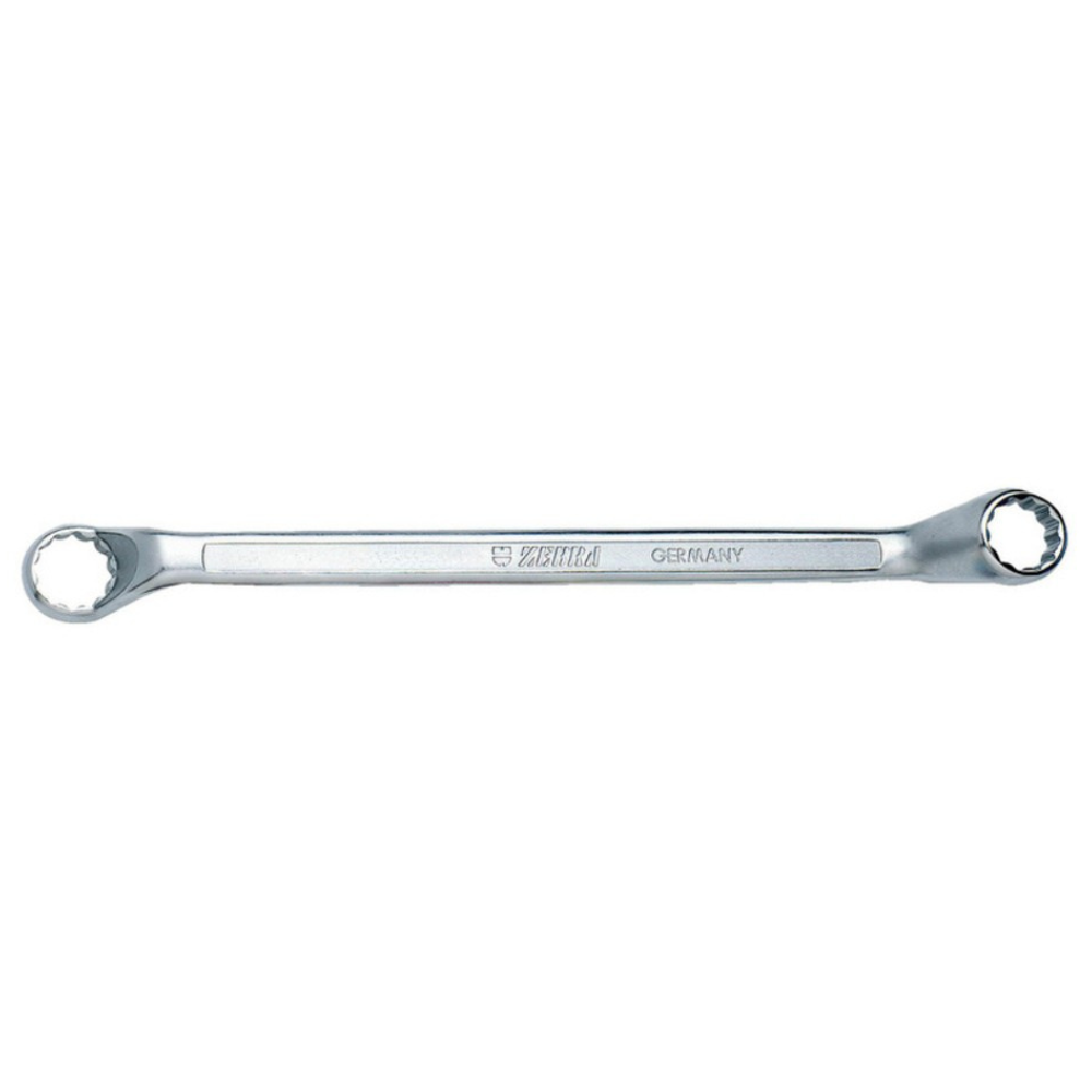

Bought a Wurth double box end wrench. On the photo of the wrench, it had Germany on it. When it showed up no Germany only Quality on it instead. It looks usable but I thought I was buying a German made wrench, I could have some Asian made wrench anywhere for less money. I don't feel like paying to send it back, so I'll just keep it.
Nobody-named-Olli
Jan 9, 2025
1,794
Current picture on the Würth app/ shop is of the 17x16 variant and says Germany on it as well, but as usual they don’t list COO. Only way to tell for sure is the Würth delivery note, that lists COO and batch. In some countries, they now have to list it on the packaging as well, I think that’s the case in the UK.
But ‘Zebra’ is definitely their good stuff, so it’s not that you got a ’cheap’ wrench of questionable quality.
I do understand the frustration though, if you expected to receive a wrench made in Germany and clearly labeled as such.
Sadly this can happen when purchasing from the big industrial suppliers, products change without notice. You still get quality, but maybe not from the same manufacturer as before. That dealer probably wasn’t even aware of the change.
I can take a look at them/ pick one up next time I’m at my local Würth. Put it on the list, so I don’t forget.
Kind regards,
Olli
I have some Wurth tools. Maybe 10% is manufactured in Germany, the rest is Taiwanese probably - anyway very solid tools. If you want German made wrenches go for Stahlwille or Hazet, then you'll be sure.

@DAustin
Picked one up at the local Würth today.
Just downloaded the delivery note and it states “D-QU” as COO.
(The latter is not a country, but used to be/ is the code for “unknown origin” when filing certain paperwork/ forms with customs. Don’t jump to a conclusion from here, I will “investigate” further. I checked some older delivery notes and found that on quite a few products …)
I’ll ask my sales rep. if he can/will share the COO of these wrenches.
I was hoping to be able to actually look at a couple of these, but they in fact only had 6 of the 10x13 in stock. No other sizes.
Kind regards,
Olli

@DAustin
Kind regards,
Olli

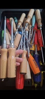

Finally, I found the last pieces for my collection. Wooden handle Wera pz1 and pz2, I think discontinued by now. I love the quality and the aesthetics of them. I also have the corresponding wihas, but the quality is not the same. I'd also try felo but I already have too much.
I will remove the varnish from them as well as the bar code.

Interesting that they went as far as to weld the bolster on these, while regular production is all pressed on.
Nobody-named-Olli
Which regular production do you mean? Are the Craftform chisel (the black and yellow ones) not welded? I was under the impression that all are welded, pbswiss as well
F-22
Jan 23, 2022
1,830
PB Swiss is welded but that is a completely different company manufactured in Switzerland.
Wera regular bolstered screwdrivers are made in the Czech Republic and have a hex shank with a bigger hex bolster pressed over it:
This is also seen on most other screwdrivers made in Europe, such as Witte and Oplast (the original manufacturers supplying companies such as stahlwille, gedore, hazet...). Same also on French made Facom screwdrivers.
To point out - this does not really make a screwdriver perform better or worse. But welding is more expensive in manufacturing and makes it more seamless. Some rare few screwdrivers are even forged out of a single piece - seems to be the case with the Vessel powergrip models.
The way these hex bolsters should be made, is that they should be forged, with the blade, as one piece!
That’s the way, historically, it was done. And it makes for a superb driver.
Here’s an old Stanley that shows this.
You are absolutely correct - most european manufacturers either press on, or weld, the hex portion.
This is, to use a British term, a bit of a “cop out”. It‘s a cheap way of getting a similar result, and that applies to both pressed and welded. Neither is ideal. In fairness you can’t really beat the value of some of these European drivers, but you have to understand the compromises.
It is, however, one reason that makes the better American made drivers worth the money (at least to me). Here’s one of my (much underrated) Mac drivers showing the forged bolster. Snap on are similar.
Pleasingly, Vessel also offer the same on their top end drivers.
I agree generally, but what drawback does a press-on one have? It does make the shank slightly weaker but typically this would not be the limiting factor except for maybe some nut drivers. For the manufacturing, it is a very good solution lowering cost plus allowing them to use their hex bar stock supply for another product. I just really appreciate the forged style aesthetically and how much more it takes to make one. I have a few of the powergrip drivers that are really excellent, as well as Willians (Snap On). The US style with the flange is certainly very reassuring.
Dave455
Mar 19, 2013
5,861
Sussex, England
The only drawbacks are that you don’t then have a “one piece” design, which has to be preferable, and of course the metallurgy will not be as good as a forged blade / bolster combo.
Is it “good enough “? Probably. Are most of the drivers made this way “good value”? Most certainly. I have a whole set of Oplast made / Gedore branded drivers that live in one of my vehicles. I paid less for the set than I would for one Snap On driver, and they are perfectly adequate.
Do I like having some really top quality drivers, with forged blades and bolsters, available? Most definitely.
I think the Williams and the Vessel’s are both very good value, though I think it’s worth keeping an eye open for the older Stanley drivers if they appear in good condition.
I bought four of these for little money. Although they don’t have the hex bolster, they still feature the forged blade, The balance is lovely.
Yeah I was mistaken, I was under the impression that all wera were welded.
However I have never ever used a bolster on a crosshead screwdriver, or flathead for that matter. Full through tang is more important imo
