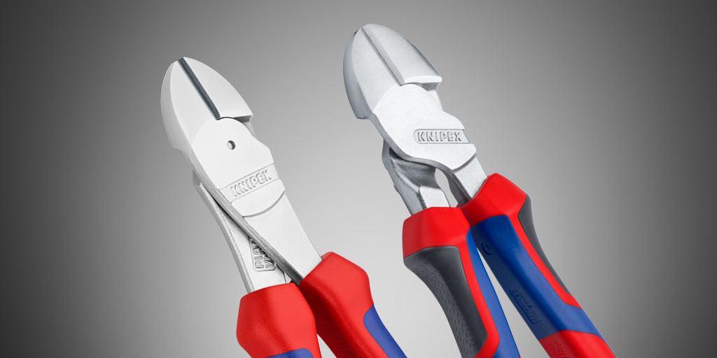

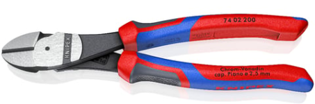

Knipex summer update
Mostly specialist professional stuff - full list in the video description. For general interest:
The high leverage diagonal cutter (at 0:40) 74 series in size 200mm and 250mm (not on the website yet), has been updated with 20% more leverage. I expect the design will trickle down to smaller sizes. https://www.knipex.com/knipex-diagonal-cutter
Below is the old version. Notice the relative proportions of the head vs. handle length. However, leverage is a trade off, so I expect the new ones require more handle movement for the same amount of jaw opening.
The timing of my recent purchase was unfortunate, so I got the new comfort grips but old mechanical design.
New Slim Knips 78 61 (at 3:30). Available with or without holster, and the holster is available separately (compatible with 125mm Super Knips)

I'm interested in either the 74 05 200 or 74 05 250.
I don't see these available in the US. Will they be? Or what would be a recommended place to grab some imported ones in the US?
Looks like they made the forged axle smaller. Seems to me these won’t have to open as wide to achieve a comparable bite to the original design.
I’d like to try them, but I have never been disappointed in the performance of the 74-250. Mine have been used and abused for years and just keep going. No other brand I have tried has been as reliable as these. The cutting edges have held up to everything I have thrown at them including 1/4” steel rod. I’ve had to stomp on the handle with my foot to cut that. The pivot design is incredible and stays tight. The handle ergonomics work.
If I do get the new version, I’ll go for the plain dipped grip.
They do say something about this:
In what ways is the high leverage diagonal cutter better than the previous model?
Thanks to its optimised power joint, it cuts noticeably more easily than conventional diagonal cutters. Compared to the previous model, it cuts 20% more easily.
My guess is the 20% is from a combination of slight movement of the axle, slightly smaller axle, maybe a slight change of blade bevel angle, and smaller handle span to put your hand in a stronger position (not too wide open) for applying force.
This page gives cutting capacities 4.6mm medium-hard wire, 3.5mm hard, 3.0mm piano. Product pages still say 4.2, 3.0, 2.5 - and so do the handles in photos.
Annotation lines mine. New version on right. Both pliers 250mm.

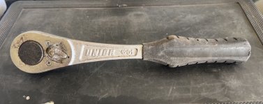

Found this Unior 1901 1/2” ratchet today. Seems like a solid tool, strong and the ratchet works nicely, although it’s low tooth count.
Any ideas on age?
Quite old. They already had blue handles in 2007.
