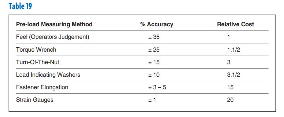

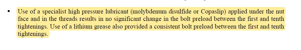

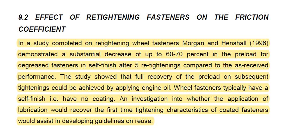

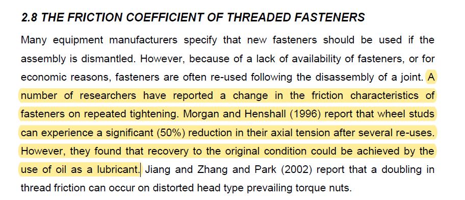

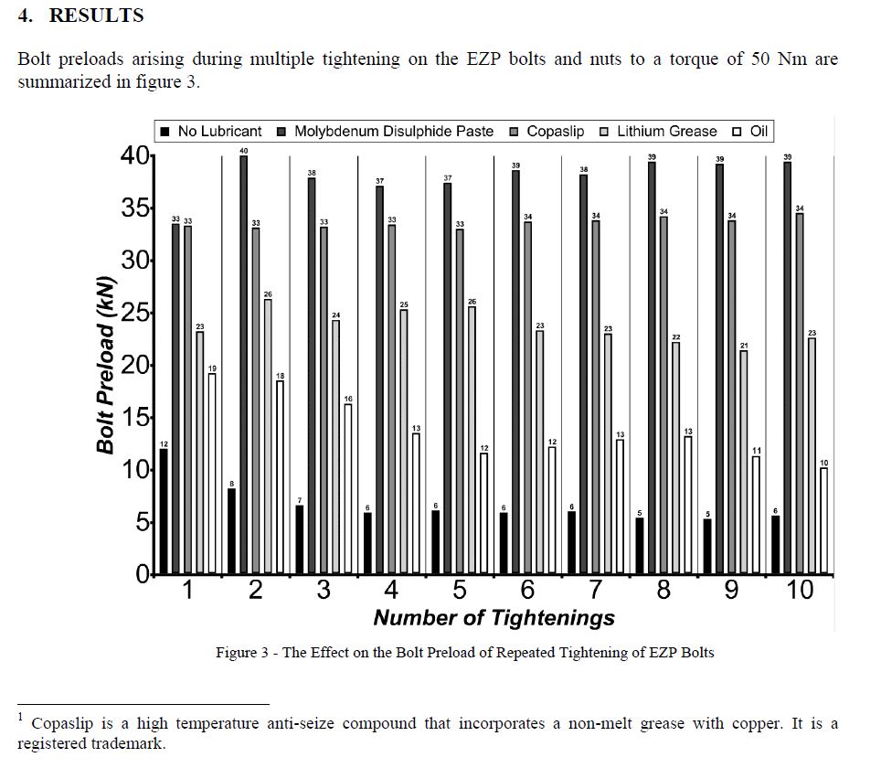

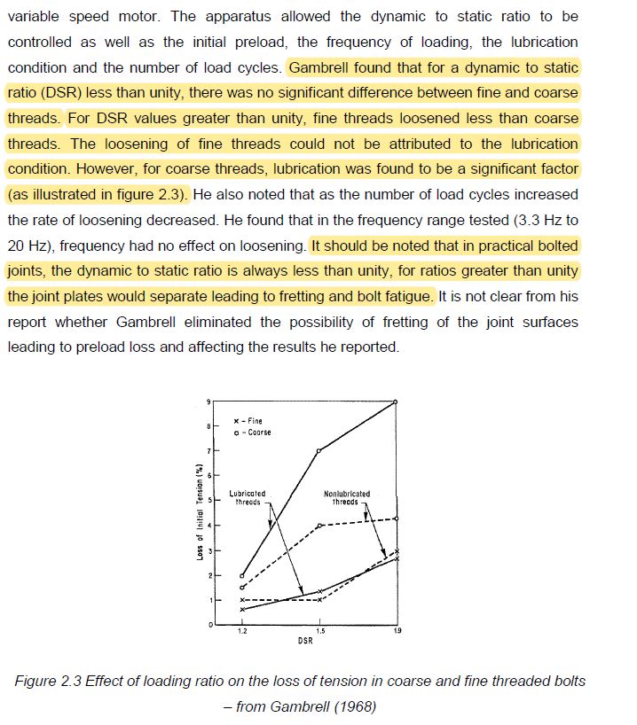

For your review:
https://core.ac.uk/download/pdf/9632852.pdf
Feel free to reference particulars.

Pretty good chart on p31 which (according to this one study) confirms my opinion.
It’s pretty simple from a logical standpoint. Want to prevent bolts from coming loose? One of the first things you do is increase friction between the bolt and nut, by applying thread locker or a prevailing torque solution.
Just as increasing friction between paired fasteners reduces loosening, reducing friction between paired fasteners does the opposite.
So we're on the same page. Are you saying, only when using coarse threads while above DSR unity is where you don't recommend using lubrication?
Because that is a very specific application.
I hope you would agree that consistency in preload is paramount over all; particularly for bolts that see frequent reuse.

Are you saying, only when using course threads while above DSR unity is where you don't recommend using lubrication?
No. I’m saying that this very narrow study (most all studies are narrow in scope, that’s not a slight against the study itself) provides a clear example of conditions where what I’m saying is true, is true.
That’s not a statement that it isn’t true under other conditions.
My recommendation is that when you take something apart, you put it back together the way the manual instructs you to. If it instructs you to lubricate, do so. If it does not, do not.
Rules of thumb like you’re promoting are generally wrong about 50% of the time.
