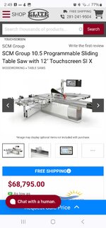

Using a table saw to rip sheets takes a run of 20' with good infeed , side, and outfeed supports. It also takes careful skill and a fair bit of muscle . Cabinet shops use saws with sliding tables, the cheap ones are about $10,000, the serious ones are $30,000.
More than that. My buddy is a high end cabinet maker and I remember his dad's saw back in the 80s cost more than $30k and that was completely manual. He bought a panel saw that was pretty much automated all digital screen table moved by itself etc and I think it was about $50k 25 years ago. He wound up spending about $1 mil for a CNC machine but that included a separate building. I think the machine itself was over $200k. Crazy expensive. He does some pretty high end work for people that money doesn't seem to be a problem in NYC and Connecticut. $100k for a custom closet is everyday stuff for him at this point but I remember him starting out with normal kitchens etc. He's done really well for himself.
Just saw this I don't think it's same brand but functionally pretty similar to his saw.
