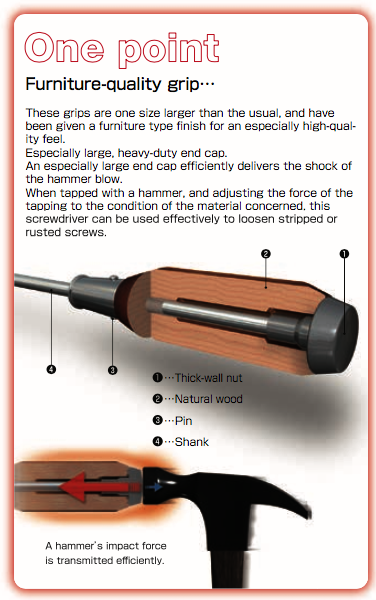

you know which vessel driver i really want to see more pics of now though?
their 100-series wood handle drivers:
https://www.vessel.co.jp/english/userfiles/handtools/wooden_E.pdf
https://www.vessel.co.jp/english/product/screwdriver/detail/111055
No. 100
Powerful Tang-Thru Screwdriver
Especially large, heavy-duty end cap. An especially large end cap efficiently delivers the shock of the hammer blow.
When tapped with a hammer, and adjusting the force of the tapping to the condition of the material concerned, this screwdriver can be used effectively to loosen stripped or rusted screws.
Luxurious furniture finish coating on the large handle, which fits more comfortably in your hand the more you use it.
Its better usability compared to plastic handles attracts support from many professional users.
Furniture-quality grip...
●Wooden handle and Tang-Thru shank.
●Long shank for fastening in a hard-to-reach space.
These grips are one size larger than the usual, and have been given a furniture type finish for an especially high-qual- ity feel.
When tapped with a hammer, and adjusting the force of the tapping to the condition of the material concerned, this screwdriver can be used effectively to loosen stripped rusted screws.
furniture-quality grip haha
