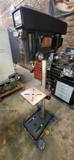

I was about to post something on buying a used drill press and I see this thread.
I see 2 benchtop drill presses near me.
1. JET drill press for $100. 5/8" chuck. Guy didn't list a model #. Looks similar to the 12" swing JET model on Jet's website.
2. Delta drill press for $125. It's an older looking model. Again no model # listed. Asking for model #'s on both presses.
What should I look for when buying a used drill press?
An alternative is to buy the WEN 4212 DP. It's 168 at lowes. Take off $20 off with a coupon. I end up with a brand new, warrantied DP with variable speed adjustment. It's 68 lbs so I can move it around without any help. I called WEN and they said the 4212 will be back in stock on March 20th.
Avoid the Wen. The Delta would be preferable to the Jet.
The Jet looks like as decent machine. $100 seems like a good price.
The Delta is missing the table and table lift mechanism. In it's current condition, it's almost unusable. If it was complete, I'd take it over the Jet.
Thanks. Going to look at the JET tonight. Reading a JET manual to figure out what tools I need to take it apart. I can’t pick it up myself and none of my friends are free to help. [emoji19]
Remove the head and table and you should be able to manage the 3 components. It helps to lean it over on some blocks to make the head easier to slide off the column. I think the head is secured to the column with metric set screws. Good luck.
Picked up the drill press last night. It was in great shape. 15" swing. 3/4 HP. And it cut through square tube like butter. I was reading the manual and it's allegedly 156lbs.
It was a bear to remove the head from the post. I laid it down on some 4x4 blocks and pulled. But the whole machine would drag across the floor. The seller stood on the base while I pulled and we finally got it off.
Thanks for the advise. Pretty happy with this machine.
