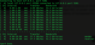

+1 for iPerf. ALSO: you need to test your test gear FIRST. I have seen many laptops that for one reason or another WILL NOT pass 1000Mb/s. why? idk. but it's true. pick two laptops/desktops or whatever and test them FIRST, going both ways.

if you're getting the link speed you should, you need to load test with data. I'd suggest you put two known good PCs on the end of this, and do two server instances of iPerf (one on each side), and see what you get. any decent NIC should be able to do near full link bandwidth. some budget NIC, or power saving features (laptop on a battery?) may cause you to not get the results you want, but a core2duo apple macbook is plenty of horsepower to do this.
here's an example of what you could see:
