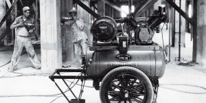

Probably not this old but looks like a Ingersoll Rand compressor. Make sure the tank isn't full of water.

Yes. I found out it’s a T-30 Model 41. I only found one other pic of one on the internet so far and that was for one in Denmark
Yep - I have two of them - they were also used on the rear of the early m2 cletrac high speed tractors - that's what mine will go back onto...
