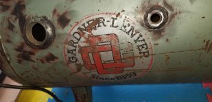

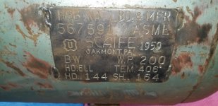

Going to inspect it this weekend. I drained some water and it was clear enough to drink which was surprising.
I'm a little concerned about trying to remove one of the screw in bungs. Doubt they have been moved 70+ years. I'm hoping I can run my little inspection camera down from the top when I pull the pressure switch off.

Me too! I have left anything directly screwed into the tank alone, and might leave it that way. There's a street el for the drain on the bottom of mine and was about half full of rust. I cleaned that out and ran a wire up inside and twisted around and around and vacuumed what came out. Then did it with the vacuum running while I did that... While I have a new pressure switch sitting here, the old one works fine, I'd just like a cover for it. Mine will be used as-is, other than more clean-up. I'll swap everything over to the other tank if this one shows signs of failing, but I'm just so sweet on it as it sits...
Not as old as yours, but still something worth keeping "alive", and for me as much as it came from the factory - no resto-work on my guy, just gentle cleaning and a nice retirement home! :) I see vintage and restored as two different things: vintage you do minimal to, restore is open season and even changing to your favorite color as you put it all back together (it's all good) :beer:
