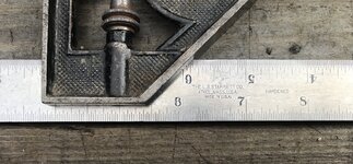

Previous to about 1900, Starrett marked tools " L.S. STARRETT", often with "ATHOL, MASS"
After that approximate time period they used "L.S. STARRETT CO." often with "ATHOL, MASS, USA"
That may shed a little light on the bottom example.

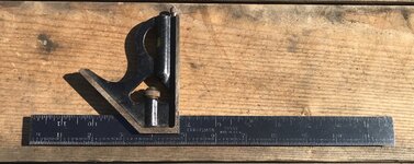

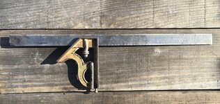

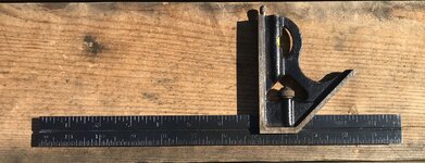

My offerings:
Maybe a PEC? Why don't they mark the bodies on these things? The rule is Stanley.
That one is my "daily driver". I reach for it at least once a day, usually more often. I use the square head most of the time--mostly as a marking gauge. I use the center-finder rarely, but I use it. I've never used the protractor that I can recall.
Here's a real Stanley:
This one lived in my tool harness for twenty-plus winters:
The green paint is mine. After many wet winters, the finish was entirely rust. Rule is a Stanley Handyman, but the shape of the head doesn't look like Stanley to me--but what do I know?
Interesting the side edges appear to never have been ground.

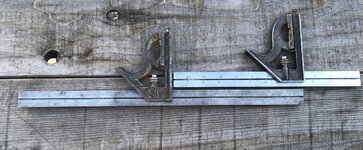

Very nice, Don! I see two heads at the top and maybe a third at the right of the group photo with the “hump” where the reinforced web meets the 45° face. My thought is these could be very early, but haven’t yet seen a catalog illustration that shows it.
Are the shorter rules thinner (as well as narrower) than the the larger ones?
16,708
I didn’t check that but I think they are the same thickness. I’ll confirm that today. There are two with the hump. One with the long rule and the one I cleaned up. The long rule is pretty rough.
13,462
4: 0.638 x 0.065
6" 0.715 x 0.080? (In theory the 6" should fit the 9", but it doesn't, the notch does not fit the tongue, or I'm really clumsy tonight)
9" 0.875 x 0.082
Substantial difference between 4 & 6” , I got slight difference on 6 to 9”, which makes me doubt the tool ( couldn’t be me), and a moderate difference 9 to 12”
12” = 0.090 to 0.096.
Will grab a better tool from work to verify them all on a single standard, and update.
