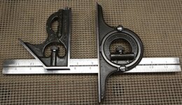

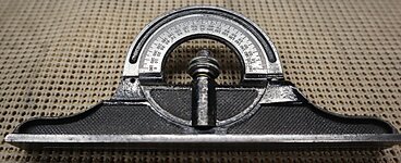

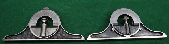

Here are my two Sawer protractor heads. The one on the left was made in Fitchburg while the right one was made in Ashburnham. The older one was listed in both catalog G (1904) and H 1910. They moved from Fitchburg to Ashburnham 1912 and changed their name to Almond in 1915. The earlier head has a single knob at the top with a stationary screw towards the bottom. The newer on uses two knobs to secure the rotation. On my older one the vial was broken so I am working on replacing.
Comparing the Sawyer to an early Starrett from the top. The bases are the same, but the Starrett is much thinner towards the top.

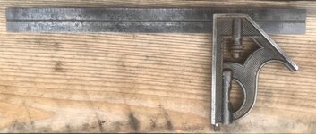

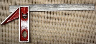

I found this Defiance by Stanley square with the scratch awl in place at a garage sale yesterday. It shouldn’t require too much rust removal. IMG_5855.jpegIMG_5856.jpegIMG_3405.png

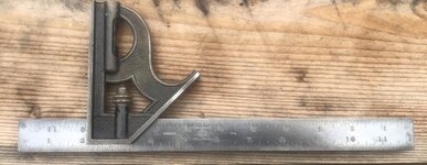

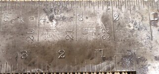

My father bought this Starrett combo square second hand in about 1948. Assuming it was purchased when a machinist retired and sold his tools it would put the original purchase prior to 1920. Anyone else have one to show?
Well, I only have one part of the setup like the OP's
I use it to find angles.....
Someone scratched USN on the front....

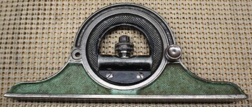

Trying to combine some Starrett protractor heads and put one into good shape. The first one, called Early, was rusted pretty bad on the exposed metal areas. The painted areas weren't too bad. Missing one small screw opposite the rotation clamp knob. Smaller than a #6 with a wide head. Starrett no longer offers these. The degree markings have a lot of pitting as does the bottom. Looks ugly to me.
The other is a #491 one painted green I called Later. Missing one rotation clamp knob and the frame is broken there. However, it has a decent center with clear markings. It also has a broken level.
So thinking it might be possible to move the center from the later to the frame of the early.
Took both apart. The center of the later was a few thousandths larger than the frame of the early. A little sandpaper sanding and it fits nicely. Then I tried to move the good level from the early to the later and nope, doesn't work. While the hole pattern is the same, the level isn't level. Side note: The early level holder is iron, the later one zinc. So now I'm fixing the level.
I'm not trying to fool anybody into thinking its all original. So I will use a plastic green bubble level. I will also drill out and tap with a 8-40 thread and use the knob off the early instead a screw so there are two knurled knobs (like the later ones).
For grins and giggle I am thinking of nickel plating this one. Will need to avoid plating the surfaces where it rotates due to tolerances.
Here are some updated progress pictures. It has been cleaned and what I call first polish. Will give it another polish before nickel plating. Waiting for a 8-40 tap to replace the one knurled screw. The level isn't set yet. May paint the holder black first.

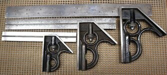

Bates Mfg. Orange Mass. Bates Mfg. was started when Sawyer Tool moved from Fitchburg MA. to Ashburnham MA. about 1908. Bates was sold to Union Caliper in 1913. 1915 name was changed to Union Tools. Also 1915 they moved to Orange MA. Looks like they kept the Bates line until the 1920's. In 1957 Union Tools was sold to Millers Falls.
The group of three Bates combination squares are all similar with the same markings indicating the Orange MA. location. None have a scribe (or even a hole for one). 12", 9" and 6" sizes. The blades not only have different lengths and widths, but also thicknesses. The blade holding nut does not use a compression spring but instead uses a wave washer. The donut shaped hole where the blade tightening nut was carried over to the Union Tool line.
The 12" stand alone is marked the same as above. Note it does have a scribe. The scribe is secured using a cam like joint.
The last picture shows a Bates center square (left) compared to a Starrett (right). The Bates does not have a raised lip on the outer edge. Compare the two knurled nuts.

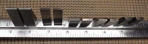

Adding functionality to combination squares are Key-Seat Rule Blocks. Made by a bunch of companies, here are five different sets. They are used to mark lines down cylindrical shafts or tubes. From left to right: Sawyer Tool, Union 310, unmarked, Starrett, Brown & Sharpe. Notice they come in various lengths and widths. Probably more important is the contact angle. The first two have about a 110 degree angle and the rest are 90 degrees. At first you might think that the short ones are for smaller work but that would not be correct. The depth the rule is inserted and the contact angle is important to the size of the work. A narrower rule for instance allows smaller diameters to be marked. The Sawyer and Union examples have a deeper groove for the rule to go into, making the rule shallower on the contact surface. They are however also larger physically. The smallest and lightest would be the Brown & Sharpe. On my next post I will have catalog pages and other info. Starrett has discontinued theirs.

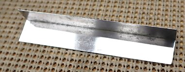

Some more Key Seat tools. The first is by Chesterman, Sheffield England. Model 802. 4" long 9/16" and 11/16" legs.

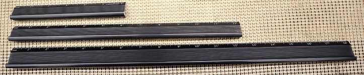

Then a group of black Lee Valley Veritas edge rules. Though not listed as for marking cylinders, they all have different lengths of legs with the long one having the longest legs. Link: https://www.leevalley.com/en-us/sho...ring/rules/111913-veritas-imperial-edge-rules
All of these have 90 degree corners.

The patent was by James H. Cook, #797559 (Aug 22, 1905). It was assigned to Sawyer Tool MFG. of Fitchburg MA.
  • US797559 Sawyer Beeswax Joint 1905.pdf
UPDATE: Nickel plated, vials replaced. Painted the textured areas. Added a square and center head to make set.

Stanley combination squares #122 and #22 both use a wire to retain the clamping bolt. Here is my example of the #22 showing how to gently remove the wire. As can been seen in the first two pictures, the wire goes through a slot on the clamping bolt. Picture three shows on the one side a recess on the 45 degree side. Using a small screwdriver of x-acto blade, lift this end until it just clears, and then using another screwdriver push the wire towards the 45. The other end will now clear and drop down. Putting back together requires holding the wire up and the springing the wire up and moving back into the notch. Tricky, but it can be done gently.
These particular models use a rule similar to Starrett's with a groove, however, they are thinner so a standard Starrett rule won't fit.

Goodell-Pratt # 707 combination square. This example is only marked "Pat Appl For" on the beam. The Rule is marked with the Goodell-Pratt information and the proper 707 model number. Have not been able to locate a patent for this design. According to the catalogs, in 1922 they refer to it as new tool and Pat Pending. By the 1926 catalog the patent is not referred to and they have a similar model 807 in aluminum. Have not see that one yet. These were sold as carpenter squares and do not have spirit levels or scribes.
