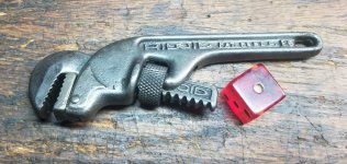

Holy ****, I can’t believe I just found this thread, and kinda by accident. But this has been awesome reading (almost) every word of this 13 page, ten year old thread. Not sarcasm even though that sounded like it.
I’ve acquired an extra interest in RIDGID tools in the past few years after using them for years and then realizing they’re kind of a big deal. Even started collecting the oldest ones I can find and restoring them. Some just so it can be used again for countless more generations, some just for fun.
And it’s even cooler that it’s real close to home for me. I work in North Ridgeville where the Ridge Tool Co. started and I drive past the Ridgid factory in Elyria a few times a week. It’s crazy to think that so many things made right there are all over the world now and after so many years still used daily even though they might be almost 100 years old. Something about a tool that’s almost impossible to break makes me want it.
I have 2 pails full of old RIDGID wrenches and cutters, some I’ve cleaned up and put to use already. The rest someday(probably never) I hope to restore and maybe sell……? Or even just having them is pretty cool too.
Recently I’ve picked up a few 6”ers on eBay. Some old, some not so old. Average about $10 each. I’ve yet to date any of them but if anyone is curious as I am I will post more when I look further in. Especially the two at the top in the first pic. The last is an 18” that I cleaned up, de-rusted, then re-rusted just for aesthetics and clear coated.

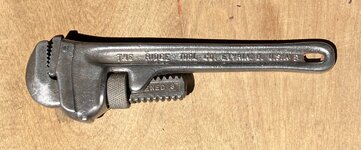

Here’s another for the inventory. Nothing fancy. 10 inch. Dynamic jaw with an assumed 1947 date; marked B.5.7, and “E” on the other side.
There is an “S” stamped on the center of the housing on one side and a dot or small hole on the other side. (I find these symbols very interesting.)
If there was ever paint on this, it is not obvious. In the handle depression there might be some black paint remnants, but it could just be old grease.

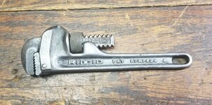

Found a 1945 14-inch with a B._.5 code on the dynamic jaw. (Couldn't read the middle number.) This one still had some original black paint in the more protected areas.
Posting this one for two reasons:
- I like the symbols on these wrenches. This one had a "5 Rx" in the center of the housing and what looks like a 4-pane window in the middle of the handle and an "E" near the hanging hole.
- The patent number is missing the first " 1 ". I suppose it could have broken off, but I don't see any indication of that.

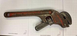

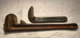

Hello all! I have a couple of pipe wrenches that belonged to my Grandfather. The first one shows the marking E14.1 on the jaw and "PAT PEND'G" on the handle. I am wonder if this is like Private Lugnutz's 1/11/1928-9/9/1929 example? The other shows the marking B.4.10 on the jaw. Can the dates on these wrenches be verified? I'll clean them both up later this week. Thanks in advance!

I cleaned up the hooks today. One thing I learned from cleaning up a bunch of C clamps and these pipe wrenches is to soak the pieces in vinegar over night and clean them with the wire brush on the bench grinder the following day. There isn't any dust and they clean up faster.
I don't think I am going to paint the 24" wrench. I can't find anything saying they were painted between 1928 and 1929. I don't see any traces of any color. I'm probably going to repaint the 18" Chevy orange later this week or next week.
I am leaning towards the 24" wrench being from between 1928-1929. "PAT PEND'G" appearing on the handle is my reasoning. I did some more research on Google and I think the 18" wrench was manufactured in 1950.
No leaning necessary. You nailed it. Not just the marking, but the other key features, as explained in this part of my dating guide in post #1...
The next definitive generation RIDGID pipe wrench has the stabilizer (4) and the trapezoidal swash plate (5), as shown in the second patent drawing, but reads "PAT PEND'G" on the handle (6). That suggests that the second patent (1,727,623) had been applied for (on January 11, 1928), but not yet granted.
RIDGID pipe wrenches with "PAT'D" in that spot (6) or the forged-in patent number "1,727,623" in that spot (7) could not have been made before the patent was granted, on 9/10/1929.

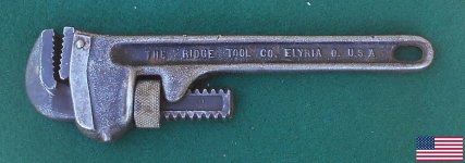

Hi, I'm from the United Kingdom and have been going through my Grandfathers tools. Among a selection of English wrenches from around 1950-1960s I found a RIGID 24” Wrench, made in Elyria, Ohio with the patent no. of 1727623 which I believe was given in 1929. There is "5 R" marked on it, not sure if that's relevant.
There is a code of B-5-4, which from reading could be from May 1944/1954 - is this correct? The photos aren't great but I can take some more soon, this was after a quick clean to get rid of any crud/light rusting.
Thanks!

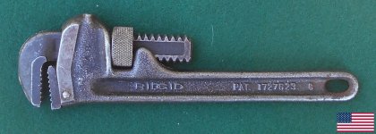

Something odd about this one - or maybe I just haven't seen enough specimens - is the small protuberance on the "back" side of the handle. I'm not seeing this on other specimens. :headscrat Ridgid 8 in pipe wrench 040926 01.jpg
Ridge Tool Co. 8-inch pipe wrench (patent 1727623)

16,691
That one is 1943 alright. The rest of the markings have never been deciphered as far as I know.IMG_0266.jpeg
I don’t know about the protruding bit, probably part of the casting process. You can see it even in the ad. IMG_6805.jpegIMG_0267.png

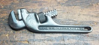

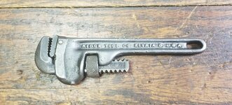

I found this little beauty today for $8. When I saw the Pat Pend'G & the little swash plate, I had to bring it home. Below are some before & after pics. Would this be late 20's?

P
30,979
Yes. Specifically, between 1/11/1928 and 9/10/1929.
The date code ("B.1.2") on your dynamic jaw doesn't agree with the markings on the handle, but the dynamic jaws are replaceable and interchangeable, and because both parts were made so well, it's not at all unusual to find mismatch pieces.
