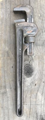

Nice, clean example. Almost certainly made in Nov 1944, when FDR was elected to an unprecedented 4th term and US, British, and Canadian forces were kicking Nazi ***, taking names and bridges or constructing them across France, Belgium, and the Netherlands.
The codes seem to switch Letter-Month-Year and Letter-Year-Month (I have an E-12-4, for example), which is a little unnerving, but the features are ALL consistent with wartime.

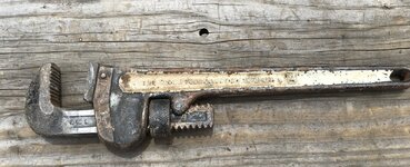

This is the key that was found in Belarus, the former republic of the USSR. Apparently he came to us during ww2 through the lend-lease assistance program! Was found at the site of military battles!08BE4125-B212-417B-B180-8BDFCCD8DF32.jpeg
P
30,930
unfortunately already difficult to see! but something ... B... 4
1944.
I have a book published in 1946 by the War Production Board, entitled Cumulative Listing of Major War Supply Contracts, that others have seen me cite as a reference here on GJ quite often. Your wrench prompted me to look at the Ridge Tool Company entry again. They had twenty-four (24) contracts, from July 1942 through May 1945, totaling $2.7M. All of them were with the Ordnance Dept, the Air Corps, or the Navy, except for one (1). Ridge had a contract (TPS41700L) for pipe wrenches worth $66,000 with the Treasury Department. Not many people realize that the Treasury Dept administered the Lend-Lease program. Guess when it was awarded? October 1943, which coincided with the Third Protocol period of the so-called "Lend-Lease" (To Promote the Defense of the US) Act. There is a very high probability that your pipe wrench was made in 1944 under that contract.
Getting Lend-Lease items to Russia was a feat in and of itself, if you're not familiar. The Nazi threat from the north to the British position in Iraq in midsummer 1941 was the sole reason for American “neutral” aid to Britain in the Middle East – and the British aid was being used as a ruse to also aid Russia, which had not yet been approved for Lend-Lease by Congress, via ports in the Persian Gulf. A railway connecting the Persian Gulf via Baghdad with the Mediterranean at Tripoli and the Bosporus at Istanbul was British controlled. Some of the best preserved Willys MB jeeps in the world are in Russia, and the "Persian Corridor" is how many of them got there. Or the Arctic route, past German-occupied Norway. But we sent enough material through Persia to Russia to field sixty US Army Divisions.
If you'll indulge me just a little longer, you may be interested in knowing that Russian Lend-Lease model Willys MB jeeps are the only wartime jeeps other than USMC models that got the full tool and repair parts package in a large OD wooden crate. All QMC, Ordnance Dept, and Lend-Lease British and Canadian jeeps got the much smaller tool and repair parts package. The USMC got the bigger crate because it would be more expeditionary, operating without the advantage of mechanics close behind in mobile 2nd echelon depots. The Russian Lend-Lease jeeps got the larger crate because those would need to be totally self-sufficient, operating on the Eastern Front, without US support. Long story short, a lot of jeep guys over here are jealous of the jeeps with crates that jeep guys in Russia are driving!
Thanks for posting.
