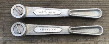

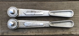

Interestingly they all have the later patent number
And they are the only S-K 1/4” drive ratchets that have the later patent number stamped. All of the conventional 1/4” ratchets through the Wayne period have the earlier patent number.
Just as oddly, the Chrome Alloy 1/2” drive beaver tails are the only S-K ratchets stamped with the earlier patent number. All of the conventional 1/2” drIve ratchets newer than the patent pending marked ones have the later patent number as do my Artisan 1/2” drive beaver tails.IMG_8780.pngIMG_2477.jpegIMG_2478.jpeg

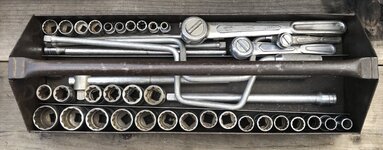

Well, this is probably the oldest SK 1/2 drive I have ever found. Nothing marked SK. Without the partial sticker on the lid, I would not know what they were.
The speeder was included and looks SK but is probably much later than the rest. Does not fit in the box.
Certainly, missing a lot and not sure if these are original pieces to this set. Any info about them would be helpful. AA has a short article on them.
