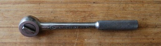

I went back and checked the S-K patents on Alloy Artifacts and the first one I looked at was patent 1,981,536, which is the ratchet in the top picture, yet there are many 3/8" drive ratchets with that same patent number that are like the ratchet in the bottom picture. Just how accurate are the patent numbers for dating tools?
13,189
if the patent number is specific to a feature like the ratchet pawl, they can make lots of cosmetic changes to the body and still wear the number.
From date of patent approval, the patent is good for 17 years. Nothing made after then should wear the number.
You really need to understand what the patent is for, some patents show up on weirdly different things some times.

They used that early patent number on all the conventional 1/4” drive ratchets all the way through the Wayne era. I think the patent number is only important as information towards a starting date.
Outlaw, I try to avoid tools marked S-K Tools on the tool itself. They are usually too modern for the era I am most interested in.
