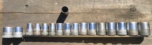

I found this partial Kraeuter 3/8” drive metric set on eBay and since I had most of the missing sockets I picked it up.

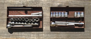

A friend gifted me these 3 vintage items. One is a partial Set 13 with the tilting case. Next is a crusty box that might be for a 4921 set but it's only 1" deep. The last is a partial 1/4 and 3/8 combo set. Part of the label is visible and reads "23 piece 1/4 & 3/8 square drive socket wrench set". Maybe set 1822? What say the more knowledgeable folks here?

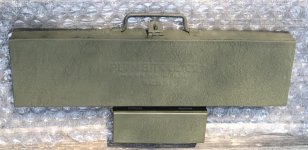

Here are a larger Plomb and small S-K box with a recent wrinkle finish repaint, using the Midwest Military paint as a topcoat over the VHT wrinkle black base. My goal was to have the formerly red ugly duckling fit in with it’s green relatives.

Don!
That looks super duper Sir! Do you spray the VHt as minimally thin as possible? Just delay the green until the wrinkle disappeares then stop? Well done !

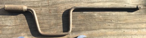

Will the wartime SK speed handles of 1/2 and 3/8 inch drive be "unnumbered" like those era's extensions?

I’m slowly improving with the wrinkle paint. I do a pretty thick coat with the wrinkle paint and let it dry, preferably in the sun on a warm day. I don’t do the top coat for at least 24 hours and I put it on thin. Below are pictures of a Craftsman box top that I redid because I didn’t like the way it came out the first time. The top coat is dark blue on those.
I believe that the speeders are unmarked as well. I picked up an unmarked 3/8” drive speeder at a garage sale today and think it is wartime S-K.

Don,
Those boxes look excellent from here, and the speeder is gorgeous. I will send you an article about a fellow who has the VHT wrinkle finish down to an art (if you wish of course). I save your tool photos as samples of what to look for myself! Thank you for the input on speeders!
