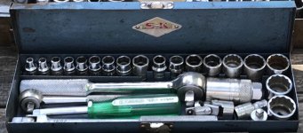

I found this box the other day. It was full of mostly crappy sockets, but did include a Thorsen 13/16" that another set needed. I am not a fan of this type of socket holder. They're too specific, in terms of height and OD and I don't see myself putting the actual set together. None of the (few) S-K sockets I have on hand fit it well. I am happy to have found the box though.
I am guessing the logo with a tan background (in Don's box) is older than this more-metallic example.
A previous owner had used a sharpie pen to put great big initials on the top, the ends and the inside of the lid. I am glad alcohol washes that ink right off.

Yeah, I’m not a big fan of the boxes with the metal tabs sticking up. I think they went to those shortly before the transition to S-K Wayne. I only have one larger blue box with that configuration.
-Don694A7E1E-6333-414F-A998-46672340AE9F.jpegD7598475-CD62-4E0C-91B9-8AD27C890FB5.jpg

Maybe in this case we can't allow for artistic license. The metal tabs in my box will not allow the 7/8" socket to fit at the extreme right side slot. For that mater, the 13/16" doesn't fit there, either. The largest socket that fits is the 3/4". At the other end of the 3/8" rail, the 1/2" can be forced into the last tabbed slot but it deforms the tabs on both sides. (Can I get a witness, Don and/or Tom?)
I'm forced to believe the older S-K tabbed case was designed for 3/8, 7/16, 1/2, 9/16, 5/8, 11/16, & 3/4. Maybe the artist who drew the depiction of the S-K Wayne case was correct when he drew the case without tabs. I know that I can get an additional 1/2" socket on the 1/4" side so taking that and the tabs away would allow the extra room needed for the two larger sockets in the Wayne case--and conform to the statement in the ad "with no duplication of sizes!"
It was a valiant effort Daniel and I appreciate your help--it just means we'll have to keep looking for an S-K ad with a tabbed case.
Given the size limits of the tabs, I'm now pretty sure about the socket sizes--the only variable is whether a 1/4 drive 1/2" socket was included in the set as a "duplicate" to the 3/8 drive. There's plenty of room in the case for the depicted drive tools--plus a 1/4" ratchet.

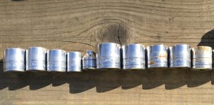

The distance that the grooves are apart. The early sockets grooves are much closer together. The earliest sockets don’t have detents to retain the sockets to the drive tools. The third picture shows sockets with the wider grooves. It’s easy to see the detents in these 3/4” drive sockets in the fourth picture. There aren’t any detents in the prewar and wartime sockets.
-DonAB2627FB-7F50-404C-8569-4E6D4F7B6B4D.jpg31E4F9B1-39AD-4E61-ACE0-43776E2F6611.jpg27CD5E1A-2165-4426-860F-FC8B22F261D8.jpgB3BAB39E-0820-413C-8E33-F8F780BE3E09.jpg
