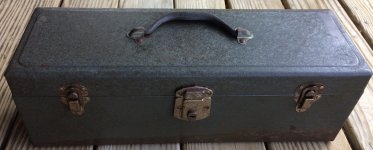

This SK carry box followed me home this weekend. It's in pretty good shape considering it's age.

That is a nice old box. It seems like it might be a good size to fill with tools and carry around in your Jeep. I picked up this postwar 1/2" drive speeder at the Tahoe flea yesterday for my S-K box.
