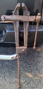

Here's a Record vise that I saw listed for sale. Aside from the pics, the only other info I have is what the seller had listed. That being that it is all steel forged and welded, no cast iron or cast steel.
I have to say I have never seen another Record like it.

Dave600
May 12, 2019
135
Newmarket, Ontario, Canada
FMC - this is a Record brand called Leader vises. Welded steel. Did come with Quick Release as an option. I have three catalog pages for them. It was not listed in the 1960 catalog but is shown in the 1963 and 1967 Catalogs. Originally the slide rail was square. In the 1979 catalog page, the rail is curved like yours is. I don't have any info in between. Here is the 1967 and 1979 pages I have.

I am assuming that this vise you posted FMC is a model 12P since it does look like a 4-1/2" jaw width. Thanks Dave for the catalog pages.

Your guess is as good as mine, or probably better than mine...but yes, it looks more like a 4 1/2. Definitely not 8" or 6". (If it was an 8", I would have driven wherever needed to get it!)

Snediker Yost Post vise model 55?. 4-1/2" jaws Joe thinks.
Just a note on Post vises, most don't have model numbers and honestly I have not spent much time searching for ones to add to the spreadsheet. Comments welcomed. Kevin
