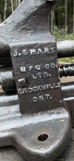

And a bit of James Smart vise information
