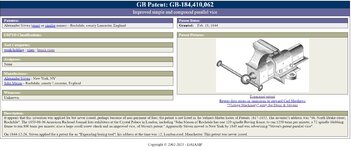

FJ, to me, the only English vise that has any sort of resemblance is Fortis. I know that Fortis did have a "Parallel" vise, but I think other English and US made vises had the Parallel moniker.
The two part construction of the static rear jaw and base was fond on some older vises.
Massey (Massy) in the USA used the design for some of their early rapid grip “quick” vises which they called their “Lightning” vises, however Massey manufactured but woodworking and metalworking vises using the “Lightning” design and name, and it seems the surviving Lightning vises are usually the woodworking models. (Unless the metalworking vises just didn’t sell well).
I mention the Massey vises, because the design was licensed from the Wilson Riley patented vise design from England, which was manufactured as the “Entwisle & Kenyon’s Instantaneous Grip Parallel Vice”.
The E&K vise design goes back to around 1881.
Both the Massey and Entwistle & Kenyon vises used the two part construction method, with the top section of the static jaw bolted to the lower section of the static jaw, but the bolt spacing front to back was further apart than on your vise.
Thanks for your input!
After more digging, I found a "Great Britain" patent vise with similar construction dating all the way back to 1844. I suspected that the vise style was much older than the 1927 catalog scan, but I wasn't expecting it to be that old.
I hope my recent fascination with Old English vices is a fad, as I can barely handle all of the unknowns with just the American vises.
