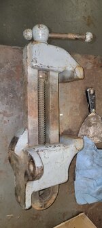

Charles Parker #825. 5" jaws that opens to 8-1/2" and weights 130lbs.
I just acquired this 825 with a 288 1/2 swivel base. The Vise nut retention pin is missing and I can’t find the hole, any chance you could share a picture of yours? If not please disregard. Carrying this 130 pound monster outside to wire wheel then back into the shop to try and figure out the mechanical issues is getting rough.
The vise nut slides down the beam then catches on what appears to be flashing from the casting, I’d just like to make it work for me.

The 825 was not mine. Pull off the swivel base and you will see the pin hole that captures your nut from sliding back. It will be a nominal diameter. Make a new pin and ***** punch the end so it fits tight, most vise makers bend the pin to keep the nut from having a sloppy back and forth movement which tightens up the backlash on your spindle. I have found that it is easier to take the vise apart so ya ain’t muscling the whole vise around while cleaning it up.
Thank you for getting back with me, I ended up snapping the bolt to remove the swivel base that ***** but not a huge deal. I’ll either sell the base or have a new bolt made. I just pushed the old rod up a bit, I will make another one at some point but for now I just want to use it.

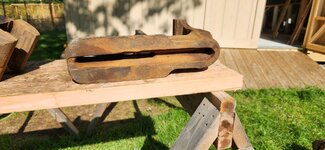

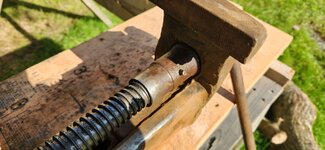

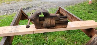

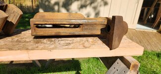

Found this Unmarked vise locally.
Would like to know if anyone has any more info on it.
So far I'm leaning towards it being a Utica vise. It seems most Utica vises are unmarked. (I've not come across any other than a picture in an advertisement which has branding on the actual vise, but we're only talking a handful of examples)
I posted in a FB group and someone has a similar but smaller version with a 4 hole base and is about half the weight.
From what I can tell there are atleast 3 different models of this vise with the square bar
-3" jaws with 4 hole base (approx 24lbs)
Jaws 3"
Height 7 1/4
Length 15 1/4
Weight 24.2
-3-1/2" Jaws with 4 hole base *can be seen in post #694 of the Vise Info thread*
Jaws 3"

-3-3/4" Jaws with 3 hole base *seen in the pictures below*
Jaws are 3-3/4"
Height off table is 7-3/4"
Overall length is 20-3/4"
Weight is 47.6lbs

Well, we can definitively say it's a rare "J. L. Ware's patent" vise, which was more than likely manufactured by the Utica Drop Forge & Tool Co.
@MayerMR has examples of both the cast "Utica Drop Forge & Tool Co." and "Unmarked" Ware patent vises.
All of the magazine articles that I found for the Ware Patent vise, mfg. by the Utica Drop Forge & Tool Co. were between (1902-1904). The following article has the best information about your vise, including specifications and a model number.
Very nice vise, thanks for sharing.

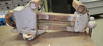

Hollands 6 R. 6" offset jaws that opens to 9" and weights 170 lbs.

PierceA
Aug 6, 2020
471
SE Michigan
I purchased a large Prentiss combination vise last week. I did not know there were ANY combination vises with jaws wider than 6".
This Prentiss 185 has 7" wide jaws. There is an example of this vise in the spreadsheet, but it shows the weight to be 240#. My vise is missing the swivel base, but is 200# without it. I doubt that a swivel base and hardware add up to 40#, but i guess it might.
So: ~200#, 7" wide jaws, 15.5" tall [no base], opens 12.5", overall length 32".
This vise has had a hard life, but is still surprisingly sound.
I have another of this type of Prentiss 'open side slide' vises, a #82, a much smaller combination vise with flat pipe jaws.
This Prentiss 185 has a maker's name on the inside of the 'wrought steel' c-channel slide. My Prentiss #82 does not.
and this #185 has an interesting mainscrew nut.. the dovetail is tapered in two dimensions, something I've not seen before on a mainscrew nut.

CRS: Thank You !
It is interesting that Prentiss apparently had to import the 'c' channel to make this style vise.

Fierljeppen
Jan 26, 2018
1,159
PierceA
Very interesting vise! I couldn't find any earlier vise manufacturers using the "wrought steel channel" as the slide.
Any comparisons between the Lewis Tool Co. and the Prentiss Tool Co. vises are completely valid, since the founders of the Prentiss Vise Co. were part owners. The very talented Mortimer G. Lewis was the brother-in-law of John E. Milford and Edwin H. Milford. So, that connection always existed.
Your Prentiss "Blake" no. 185 is the largest jaw combination vise I could find and was first offered in the earliest of 1900, as seen in the following documents.
1900_01-13_the_metal_worker_v.53_no.2_pg.39.jpg 1900_prentiss_cat_no.46_pg.33.jpg
The fact that the Prentiss Vise Co. imported the "wrought steel channel" from Dorman Long is very interesting. I wonder if they marked the long raw, uncut channel once and you got real lucky to have gotten that piece or they were marked on all of the channels?
Either way, it adds a little a little more historical value to your vise.

Thanks everyone! I'm grateful for the research done, and shared for all of us to see.
The wrought iron channel used in this vise appears to be the largest size shown in the Dorman Long info.
But with a slight bit of machining i think. The vise's dimensions are just slightly smaller than the published channel dimensions.
Thanks again.
Pierce.

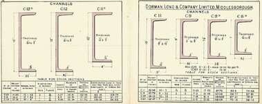

CRSINMICH
Aug 15, 2015
2,459
Southeastern Michigan
PierceA: That was the largest wrought steel channel on that page. There were more pages of channel in the catalog. I'd like to see a vise that would use any of these channels.

PierceA
Aug 6, 2020
471
SE Michigan
I agree Kevin. As well as have squared edges on the channel. It appears to have a formed or rounded edge in the catalog sketches.
Question: Wrought Steel vs Forged Steel: What is the difference? Forged to me means very heavy hammer-machines to shape the steel. What and how does that differ from 'wrought' steel?
The blacksmith post vises are 'wrought iron'. And they are amazingly tough.. I watched a guy take a 12# sledge and a full overhead swing with the sledge hammer and hit the jaw tops on a blacksmith post vise. And the sledge hammer just bounced off.
I'm wondering if someone can post a link to some site like: 'Metallurgy for Dummies'.com. Which is what I 'd need to start with !

Mg3442
Apr 2, 2018
5
Prentiss 183 with 6" jaws that open to 6", Weights 185lbs and has the side open channel. God awful blue paint job on this one.
Hi just picked up a 183 like yours Did you remove the lead screw from the slide assembly for the restoration? if so how? my lead screw retainer is missing and I can't see how it would work. Any help on what the retainer looks like or a picture would be appreciated Thanks Pete in Medway ME
