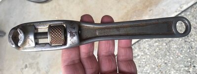

I recently purchased a box of tools and came across this. I haven't been able to find out very much after quite a bit of searching.
I was wondering how rare this is, and if it has any value at this point. Please help me out I'd like to understand what I have. Thanks in advance.

That's an interesting twist I do not believe we've seen before.
Ted Neff was the man who invented the "Adjust-A-Box" adjustable box-end wrench:
Neff Enterprises "Adjust-A-Box" adjustable wrench (patent 2912891)(photo Davegvg)
Neff / Neff Enterprises Inc., 1575 W. Rialto Ave., San Bernardino, CA 94210 / "Adust-A-Box" adjustable box-end wrench / patent 2912891 Nov 17 1959 & 3173317 Mar 16 1965 & 3283623 Nov 8 1966 & D409462 May 11 1999 Ted Neff / https://www.garagejournal.com/forum/threads/neff-adjust-a-box-wrench.393538/ /
Your copy down in the bottom of your tool box is probably branded "Craftsman".
The "Vogel" two-sided ratchet was invented by one Mr. Vogel, and manufactured by Proto in Los Angeles.
Vogel / Vogel Tool Co., Los Angeles, CA / "double duty" ratchet patent 2803980 Aug 27 1957 Irwin R. Vogel / (manufactured by Proto) /
Just a wild guess, but it would appear Mr. Neff was also promoting and peddling the Vogel ratchet.
