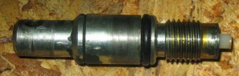

I've put my Walker 93652 Series E 2 Ton back together again and it won't lift. Not an inch.
To recap: I removed the hydraulic cylinder from the frame. I unscrewed and removed the release valve assembly. I unscrewed and removed the pump assembly. I attempted multiple times to removed the slotted gland nut and was unsuccessful. Since the jack actually worked previously and was only leaking a small amount of oil (from somewhere), I decided to put everything back together in preparation for putting on snow tires in a day or two.
Screwed the pump assembly back into the hydraulic unit and tightened. Screwed the release unit back in and snugged. Put the hydraulic unit back into the frame. Removed vent plug and added oil to cover cylinder visible in hydraulic unit prior to adding oil. Opened release valve one turn and pumped handle rapidly ten times. Closed release valve and pumped handle but the jack didn't lift. Repeated with no success.
With release valve closed, I lifted the jack by hand to fully up. Strong sucking noise heard. Opened release valve one full turn and extended jack didn't go down. Pushed the extended jack and it went down rapidly. Closed release valve and pumped; jack would not go up.
Repeated the above. No success.
Added oil until it came to the level of the fill hole (which, I believe, is too much oil). Repeated all of the above with no success. One change though -- this time after raising the jack by hand, opening the release valve and having the jack not go down, I again pushed it by hand and it went down rapidly, this time pushing a quantity of jack oil out the fill hole in a two foot radius of the jack. That's what paper towels are for!
Reviewing the beginning of this discussion thread, I see where the OP has removed a conical piece of metal from the release valve hole. I did not do this, nor do I find it in the hole now. It is not in the area where I attempted to remove the gland nut and it seems a bit too late to check the area of the shop I took the the unit to a while back (twice).
My symptoms seem to fit the scenario where the actual release valve is missing. Photos below of the release valve assembly and the hole it screws into (now filled with new oil; a pick goes in quite deep below the surface of the oil and the only thing felt deep down is what I'm guessing is an oil port hole).
Opinions?

Can't see for the oil, but just below the surface should be the flat end of the release valve. It is a turnip shaped metal piece. If you've lost that, it must be replaced. They do fall out at the most odd times when working on the unit. Without that being closed, it will not lift.
Turnip shaped -- good description. I'm pretty sure it isn't in the hole as a pick goes at least 1/2" below the surface of the oil before hitting bottom.
AH.. the Old Missing Release Valve, Almost as common as the "The Jack was working and I loaned it to my Neighbor and Now it doesn't work" Story..
PM, Responded too.
