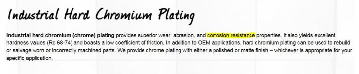

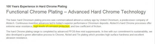

EDGAR
Aug 21, 2010
437
Quote from Pop Pop:
"Chrome plated rods are for wear, not corrosion"
Really?:lol_hitti
And that is why every single earth moving equipment, with hard chromed rams, left outside getting wet every time it rains has rusted rams. Everyone has seen that, right? I don't think so, unless the ram was mistreated and the chrome was damaged.
No one has denied the fact that the hard chrome plating gives a harder wear surface. That was not the point I was trying to make. But, you do not seem to know that it also provides corrosion resistance. Many persons know that, at least. Have you ever seen up closely one of these earth moving equipment, or any other kind, with hard chromed rams? No? Yes? Maybe?
Really?:lol_hitti
Speaking in general, when anyone decides to comment on something, it is best if the person has done some previous research about the topic instead of saying the first thing that comes to mind. That way that person does not look bad.
