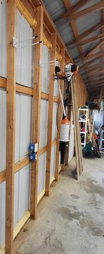

I went with 2"x6" commercial girts (flush to both the inside and outside) on 2' centers for my build. Here are some old photos to show the "bones". It's all insulated and finished now. The nice things about installing the girts in a "bookshelf" or "commercial" fashion is that it reduces the amount of lumber necessary, provides increased wall strength against high winds, creates perfect bays for pre-cut batts of insulation (literally open the pack of insulation and plug each batt into the bay), and makes installation of interior sheeting a snap (no need to put up interior girts or frame out the inside of the building).

We purchased a piece of property a few years ago and it had a shed on it. The previous owner was sick with cancer and passed away 3 months after purchasing it. I would really like to steel line the shed but can't figure out the best method with the way it is constructed. I've attached 2 pictures to show what I'm up against. The studs are 24" OC. I thought about running perlins but then I've pretty much got to frame in the doors, windows, garage doors, walls, etc.... Seems like a lot of 2x4's (or 1x4's). Also, the side walls of the shed on the inside are 10'4" tall. Why?!?!?! Why not 10'?
Any help would be greatly appreciated!

Run the steel horizontal. That's how it was done at our farm shop but be aware that dirt and dust will settle on the ribs. I don't think it looks as good either but it's a working shop so I don't dwell on it.

Why metal on the inside ? osb is cheaper and your walls are already framed to accept it, add some insulation then osb then two coats of kilz primer and paint. with osb it will be easier to hang shelves , cabinets and attach other things, just my opinion.

If you want to keep the metal vertical, just bookshelf girt it.
