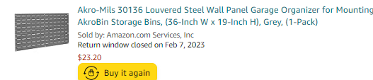

I have a bunch of the akro mills type bins that are supposed to be able put on louvered panels, but not the mounting system. HF sells those cheap parts racks for $25 with the bins that has a mount for them, but if I try and source something like that by itself, it is very expensive. https://www.amazon.com/Akro-Mils-30136-Louvered-Mounting-AkroBins/dp/B003BT4G8Y?tag=atomicindus08-20
Does anyone know of any cheaper options? Don't want to spend $100 to put up some $1 bins if I have an option.
These are $25 each

Offf, I bought several of those just a few years ago for around 25$ a piece.
;) Yeah 4 Pack
Ordered on September 25, 2023 as AWD.
And a one pack
Yet another order but back in 2018 for retail.
But todays retail is absurd.
Edit: And forgot this one, also AWD
