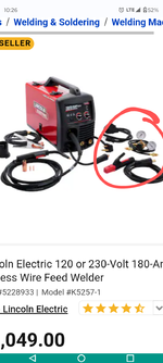

Interestingly enough I never checked Lincoln and they do offer a welder that seems to be in my price range and it seems that everyone says at some point you should just go red or blue. Also this is a multi process so if I did want to try something else other than mig I could.
Thanks guys for all the help and suggestions :)

I do not have the space for it. If I have a car pulled into the shop it would be very cumbersome to move around. Also will take up a lot of precious space. Also if I ever have to weld somewhere not at home it would be a biatch to load up.
you wouldn't go wrong with a lincoln. solid machines.
