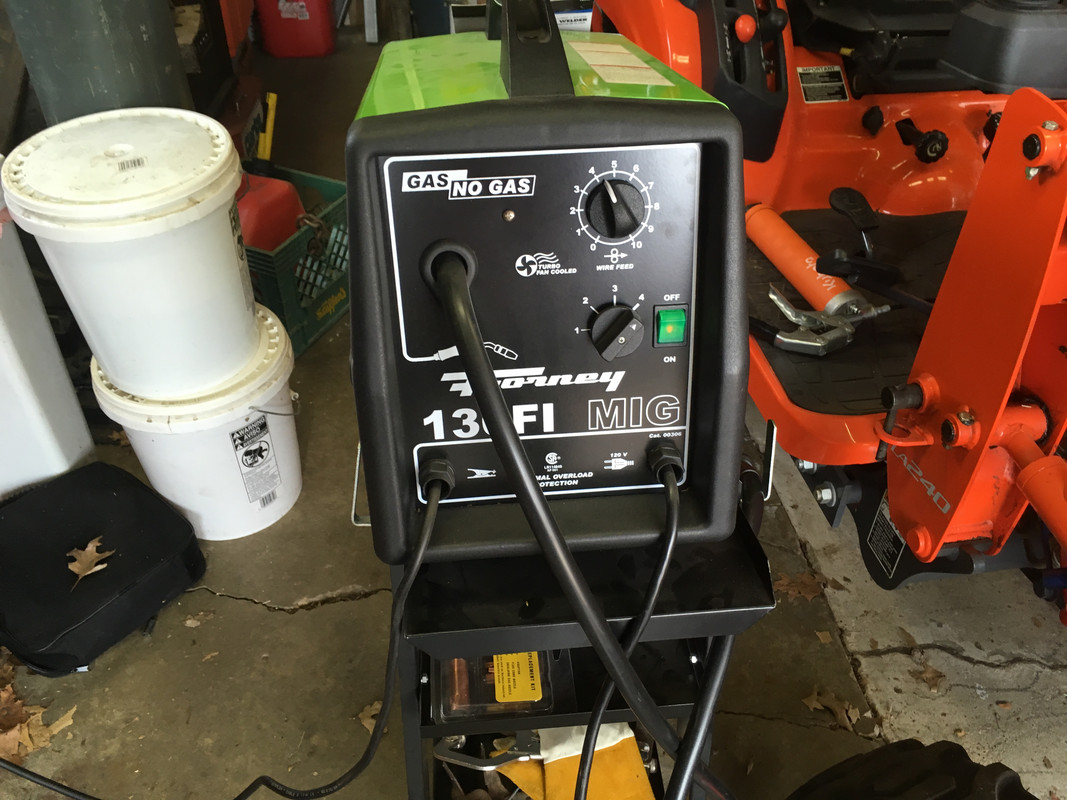

I bought this “Forney” 130 amp wire welder new for around $225. Yes, Lincoln Electric, Miller, Esab, or Hobart are better machines. The one I have is the same one labeled by Craftsman, HPC, and the older Clarke. The Clarke has three heat settings, mine and the others have four.
It’s surprisingly capable. Just a couple of day’s ago, a friend from the County shop stopped by to use it on a suspension part that broke. It was able to weld the part from two pieces back to one, even outside in below freezing temperature. He was impressed with my budget machine and he’s used to using Miller’s top of the line stuff.
I’m not saying it’s the end all of welders, just that I found a great machine to learn on at a good price. Plus, since it’s a 120v and not a show piece, if I need to haul it around, I can. I took it to welding class, one day, to have the instructor help me on my own equipment. When he ran it, you couldn’t tell the difference between my cheap welds and the school’s much better flux core 120v machine.
