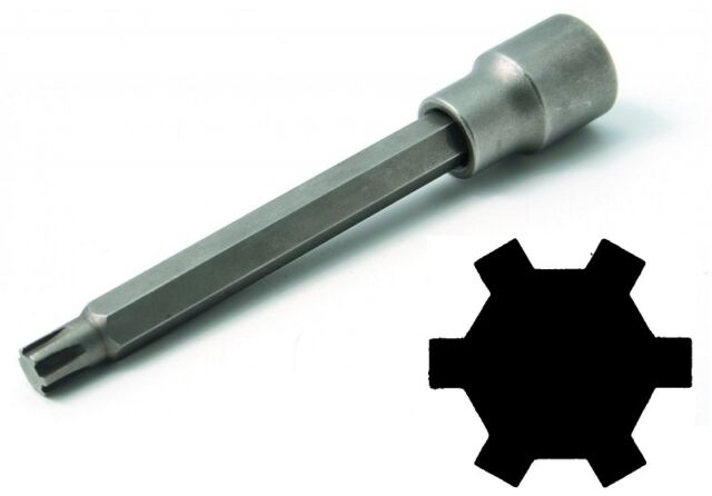

06 Wrangler 4.0. T40 torx too loose, T45 won't fit. T40 fit perfect in the tensioner bolt btw. Is there a special socket bit for this?

That should be a Litens tensioner.
Its Torx Plus.
And be sure to grind the "staking" spots down on the backside of the bolt or you will damage the female threads removing it.

Torx plus? IE, another set of tools you didn't know you needed
Well the Torx patent DID expire. However the new design IS improved as it can handle higher torque loads and being a perpendicular wall design rather than tapered it's a good deal less likely for the tool to slip out stripping the hardware. All in all a great improvement but yes still another set of tools to buy. LOL

FWIW, a Torx bit will fit into a same-sized TorxPlus socket, but not vice versa. If you have both tools, always try the TorxPlus first.

Interesting - a while back, I bought a new tensioner for my 23 year old E36 series BMW. They changed that fastener from what was originally a hex to what appeared to be Torx. I used a T50 to slack off the tensioner, but I had problems with it camming out, as it takes a fair amount of force. Now I'm wondering if it wasn't Torx Plus. I ended up replacing the Torx with the hex bolt (which is LH thread) off my old tensioner.

Sounds like it. TorxPlus is a bit annoying because none of the US socket-head tool manufacturers seem to make keys or drivers for it. SK has TorxPlus bit sockets, but neither Bondhus, Elkind, Chapman, nor Wadsworth seem to have have any tools for it.

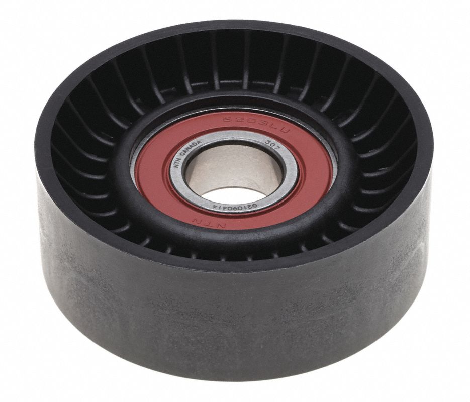

The pulley is usually replaced; especially if a belt or other parts have to be ordered anyway. But the nearest parts store is a 40 mile round trip, and Amazon orders take two or three days. If that squeaky pulley is the only issue::
I usually have these common bearings on hand, and have multiple sets of drivers, pullers, and a hydraulic press. For Me; Installing the bearings is usually a simple task that only takes a few minutes, whether the pulley is steel or plastic.
If a pulley gets destroyed trying to do this; there is no big loss.
I have sincere respect to the OP for His desire to avoid Chinese parts or bearings. The lowest cost tension assembly from Rock Auto that was mentioned would likely also fall into this category.
A
atikovi
Feb 14, 2009
2,136
Suburban Washington DC
Well, this is what the picture of the Gates pulley showed. An NTN bearing made in Canada
45VE96_AS01
What was sent had no markings on it and the box said made in Korea. I contacted Gates and they replied the bearing in that pulley is now made in China. They wrote, Gates validates our bearings to meet durability and noise standards. We only use bearings from approved suppliers. The bearing in the 38018 pulley is made by Zhejiang BH Bearing Co.,Ltd., China. I wouldn't have spent $14 on it when I can get one for $3. Should have learned my lesson about Gates the last time I bought a water pump that was made in China too.
BDT/NWMN
Jan 22, 2012
3,762
Erskine, Mn
45VE96_AS01
I looked at the picture of that pulley when You first posted the link; and I gave a smile and a thumbs up when I read the Canadian markings. Gates can claim this or that;;; but what You received is clearly not what is pictured.. I would be disappointed also. I used to look at Gates as a respected company. I also noticed the China label on the last Gates water pump I bought. If they are going to operate a "white box operation" it is unlikely I will be spending extra for the Gates "name".
