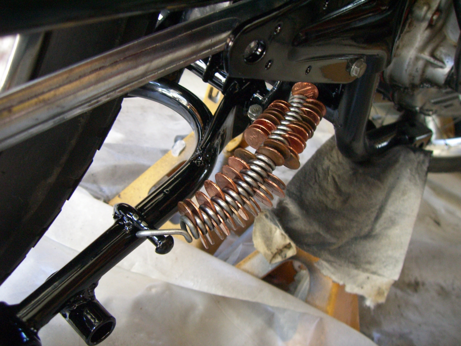

Depending on how much slack you need, you might try something like this in a pinch. For that tiny spring, I'd get a tin snips and cut up a piece of galvanized flashing into little pieces, maybe 1/8"x1". Put the spring on and then yank the shims with a pliers.
