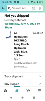

I figure we only live once on this Earth I might as well get the one I wanted.
I had not picked it up yet from Menards,
And they told me I could just cancel it without penalty and they would credit my credit card back I went ahead and ordered the
It should be here July 7th.
I got it for $462.92 through Amazon warehouse,
But I made sure I can still return it if there was anything wrong and I made sure that I still had the same warranty from the distributor or the company the manufacturer they answered me on Amazon
