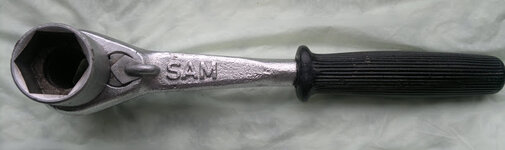

finally found the old SAM PTT pass-through ratchet and the couple sockets i had in Marseille: pics later in the day! :D

Impressive pix, cosmik. The fonts and teeth height differ on the sockets indicating different manufacturers or different time/machinery at same mfr.
i think either Facom or SAM is the socket manufacturer since there always were close ties between the two and only the ratchets were made in-house by both... ;)
Do you happen to know whether the sockets interchange with the Facom 67 series?
yes, same specs and the same PTT contracts were awarded/split to both manufacturers so interchangeability for those tools was a contractual obligation. :)
Thank you so much again cosmik. I now have the Facom and SAM models in a separate group. I can't in good conscience put them in the same group as Armstrong/Matco as Neophyte indicated unless I get a sample to check with.

we'll have to ask Teken for that since he owns(owned?) a few sets of Armstrong Eliminators and could count and measure the toothed section, lengths, various diameters of their sockets if he does still have them.
i'm not sure that either Matco or Armstrong licensed the Facom/SAM design since their patents listed in a previous post are from around 1999 and the SAM ratchet i do have has been made in 1979 and was available for well over 15 years prior to that date... :)
seems more like a new, patentable, way of modernizing an old pass-through system for Danaher Corp.

Cosmik,
I looked a pic of the pawl in the thread you linked; then I looked at the pawl in your pic. They appear different. I counted the teeth on your sockets as best I could. They seem to be 30.
I have one of the Armstrong sockets: a 3/8" drive (equivalent) with 36 teeth. Armstrong also made a 1/2" drive. If the tooth count on those is also 36, then it seems Armstrong/Matco and Facom/SAM don't swap.
What do you think?
