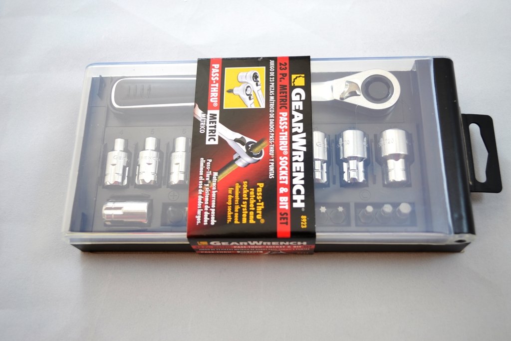

After finding that none of the local Sears/Ace stores stocked the 1/4" pass-thru ratchets, I decided to pull the trigger on this Gearwrench set (8923)
Currently available on eBay for $22.22 shipped, I figure that's about as good as it's going to get. Here's the ebay link, realizing it will be short-lived link, but might be useful for someone in the short-term.
https://www.ebay.com/itm/New-Gearwrench-23-Pc-8923-Metric-Pass-thru-Socket-Slotted-Phillips-Torx-Hex-bits/122356271954?ssPageName=STRK%3AMEBIDX%3AIT&_trksid=p2060353.m1438.l2649
I totally forgot I had those sets in both sae and metric. The ratchets are complete junk. Both states skipping almost immediately. Hopefully you'll have better luck then I did.
I've used this ratchet a couple times now and it's worked as designed. Since it's effectively equivalent to a 1/4" socket I haven't used it for big-torque requirements, but I've certainly used it where the GearDriver Handle wouldn't deliver enough torque.
Now that I've got three different sets of pass-through socket sets (all Vortex GearWrench), I decided to just get a dedicated toolbag for all three. I would have just preferred that they included the ratcheting handle in the GS80060 set. I even tried to figure out a way to make a space in the molded case, but no luck.

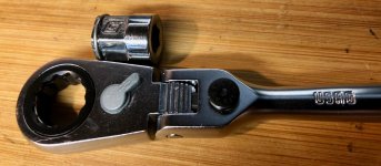

Does anyone know of another set (or square/bit adapter) that’s compatible with the Facom/USAG/Wera through ratchets? Ratchets are are 11mm 12pt with retaining ring, and sockets are 6pt with notch.
I list them together because I assume they have the same OEM. Wera Zyklop FA sockets work on the USAG locking flex through ratchet.
JBH
Jan 17, 2018
812
Pix or links w/same would be helpful.
Fair enough. The attached pictures show the USAG ratchet and 7mm through-sockets by USAG (my USAG kit came with sockets stamped with the Facom logo, as you will see below) and Wera, as well as Wera socket on USAG ratchet.
