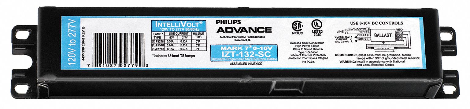

2 many,
I take contention with your "NO fluorescent lamp is dimmable" comment above...
Using Advance Mark 10 Powerline dimming ballasts, you have FULL DIMMING CAPABILITY, using LINE VOLTAGE DIMMERS (less than $10 each), from 5%-100% full range, flicker free.
I'll believe 5% "flicker free" when I see it.
Just as I said in my other post: standard in stock fixtures wouldn't have those ballasts in them. But telling someone that they don't exist, is simply not true. I sell thousands of them per year..
http://philipslightingcontrols.com/mark-10-mark-7
Uh, huh. At $150+ a pop:
http://www.grainger.com/product/5KB39
5KB39_AS01
...which brings us right back to what I said about requiring "some rather expensive dedicated controls to accomplish even that much."
And why you would suggest against using 8' tandems, is beyond me..
Because, with the potential exception of trivially less installation hassle/expense, they buy you NOTHING which cannot be accomplished with two individual 4-foot fixtures, AND they impose additional limitations which are themselves undesirable.
an 8' tandem would be considerably less expensive than 2- 4' fixtures.
That simply isn't true. The least expensive 8-foot tandems which have been mentioned here are in the realm of $40 each. Decent 4-foot fixtures can be had for little more than $20 each (one of my favorites is $22 at any Lowe's you happen to have handy).
Even if he went with dual ballast 8' fixtures, he could switch them independently, and have in effect "dual level" switching, to reduce light output for tasks which didn't require the full light output.
Dual-ballast fixtures will drive up the costs still further vis-a-vis those "$40 specials" noted above. And you STILL forfeit spacing flexibility.

got my hands on 11 of the Menards fixtuers. Opened the first one up and guess what? Philips ballast! Score!
So they should have the same 5 year warranty.
The American Floursecent(menards) fixtures are wider and seem to be better made. They are also a good deal cheaper.
The American Flourscent are assembled in the USA of foreign and domestic components. They have a two year warranty.
The Coopers Metalux have a one year warranty, not sure where they are made.
Picked them up for $32.98 on sale. I'm tickled. :thumbup:

Hung 6 of the Menards fixtures yesterday, still impressed with them.
Also the plug in for the ballast has an extra space for wires going out to hook your fixtures inline. The coopers did not have this.
Going to hang some more today, happy as lark with them.
