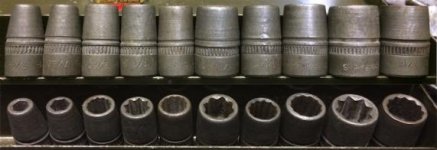

I remember there was a post tht summed up who they were and what years they were made but I can't seem to find it.
16,703
They are actually called D-I sockets and they were made by Duro Metal Products during WW2. It is commonly thought that the D-I stands for Duro-Indestro and most of the brand has either Cad plating or are plain steel finish since they were made during wartime metal restrictions. I have quite a large collection of them in my WW2 toolsets.
29,774
^ spot on. lists below thanks to Private Lugnutz:

Nice socket. As stated above, Duro Metals made your socket. The *** banded knurling makes it early war transitional before they went to the llll knurling on the sockets.
Here's a few other examples, Duro, D-I, Chromium Vanadium.
Here's a set that I own, all D-I marked 1/2in drive 12 point.

Most of the early (EARLY) sets came with:
1/4, 5/16, 3/8 8-points (not all)
At some point the inclusion of a 1/2" (6-pt or 12-pt) became more common.
At some point the exclusion of the 8-point sockets became the norm.
Again, there are no constants on this one. You would have to pore through vintage catalogs to get a better picture of what each manufacturer was doing.
There are all kinds of older tool catalogs you can download at ToolArchives.com - check that out as a reference source.
16,703
The only sets that came with the D-I socket in your original post that I have run across are these sets with both 1/2" and 3/8" sockets and several other drive tools. These come up for sale occasionally.
Username already in use
Sep 4, 2015
2,177
Show-off... :drool: :beer:
Those are nice Duro sets. I have a smaller type set that came with only the 1/2" drive stuff. I think there's supposed to be a short type speeder in the box as well, but I'm not 100%.
  • 1:2%22 D-I set.jpg
    1:2%22 D-I set.jpg
16,703
Between us, we seem to have quite a few D-I sockets. They seem to have offered them in many different sets. Here is another smaller set in a box marked Indestro next to a Duro marked set.
