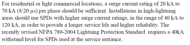

I am not a sparky so flame me now for wading into this....
I read thru the attached IEEE guide (2005, so 20 years old.....) to try to educate myself before I went on my surge protection journey.
Section 2.2.2 talks about Surge Current kA ratings (pdf Page 27, document page 18).
My 200A main panel is a Cutler Hammer CH. I recently installed a CHN250SUR which is a combination surge protector and breaker. It is a 2-pole 240V50A breaker and I installed in space 1/3 adjacent the main breaker. It also feeds the range. It has a surge current capacity rating of 36 kA per phase so low-mid range of the Residential (20-70 kA) recommendation of the IEEE guide. But its directly connected to the bus with a short lead to the ground bar which I understand is best.
About 3 weeks back my pumped septic controls were smoked. Second time in 3 years - this time just the floats were fried ($680), last time the entire digital controller and ultrasonic level sensor fried ($4k). So this time I installed a Square D HEPD80 on my 4-wire feed exterior septic sub-panel attached to the house which has a 80 kA rating (high lightning range) and this is connected to a 2-pole 20A breaker (instructions say 30A max, but no min.....). I connected it to spaces 1/3 which is as close to the main lugs as I can get it.
At my outdoor heat pump unit, I installed an Intermatic AG3000 with a 20kA rating directly connected to L1, L2, and G on the line side of the disconnect using proper wire nuts and not double tapping. This is at the bottom (low) end of the recommended residential range per the IEEE guide.
I still need to do the basement sub-panel and the detached barn sub-panel.
There are also other competing ratings to be compared but my head started to swirl when I dove into those (MCOV, VPR, SCCR, etc).

Page 19 states:
"The authors recommend a minimum surge current rating of 20 kA to 70 kA (8/20 µs) per phase for SPDs to be used in residential or light commercial service in low or moderate lightning areas. For houses in lightning-prone areas, or with severe exposure, higher surge current ratings in the range of 40 kA to 120 kA should be specified."

It's an old guide for sure. But lighting hasn't changed much since it was written. My house is still fed from a 3 wire secondary distribution system with a multi-grounded neutral.
I do have tons more sensitive electronics in my house now. Any one of a number of sensitive pieces of equipment cost more than my SPD.
Some literature states you can get by with as little as 10 kA SPD on the bus in your panel. And longevity may be lower than that of a larger device.
All in - between the advice of the IEEE guide and the local POCO in agreement, I'm good with the 80 kA I have and some local surge protection at the receptacles and I/O ports of the expensive electronics.
