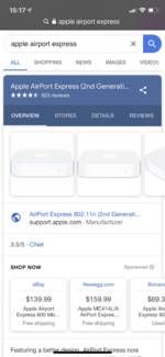

I have the extreme in the house and express in garage connected by an Ethernet cable, once hooked up it pretty much sets itself up. Few clicks on the computer and your up and running

I’m using the power line device to get to my garage, and rather successfully, although I only use it for surfing and music.
I did note that the device doesn’t work on all outlets. I surmise it only works on the outlets that are on the leg that the “transmitter “ is plugged into in my basement, near the router.
I later put an outdoor range extender of some sort . That works at getting signal to my metal garage also.
