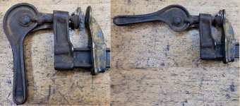

jim: Nice catch - a Type 2 No.45! Those don't show up every day. I'm with Drives, I knew you'd already have some. In fact, when I picked up this Colt #50 cam action cabinet clamp yesterday, my first thought was that you'd already have several. I'd really like to see your collection of vintage tools someday.

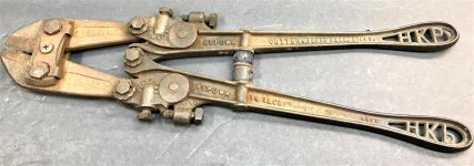

Not a woodworking tool. Just a really cool looking tool from the age when they were made more decoratively than they needed to be. It's an HK Porter HYPOWA bolt cutter. Check out the HKP piercings on the ends of the handles. This came from he same estate sale where I got the Colt clamp.
